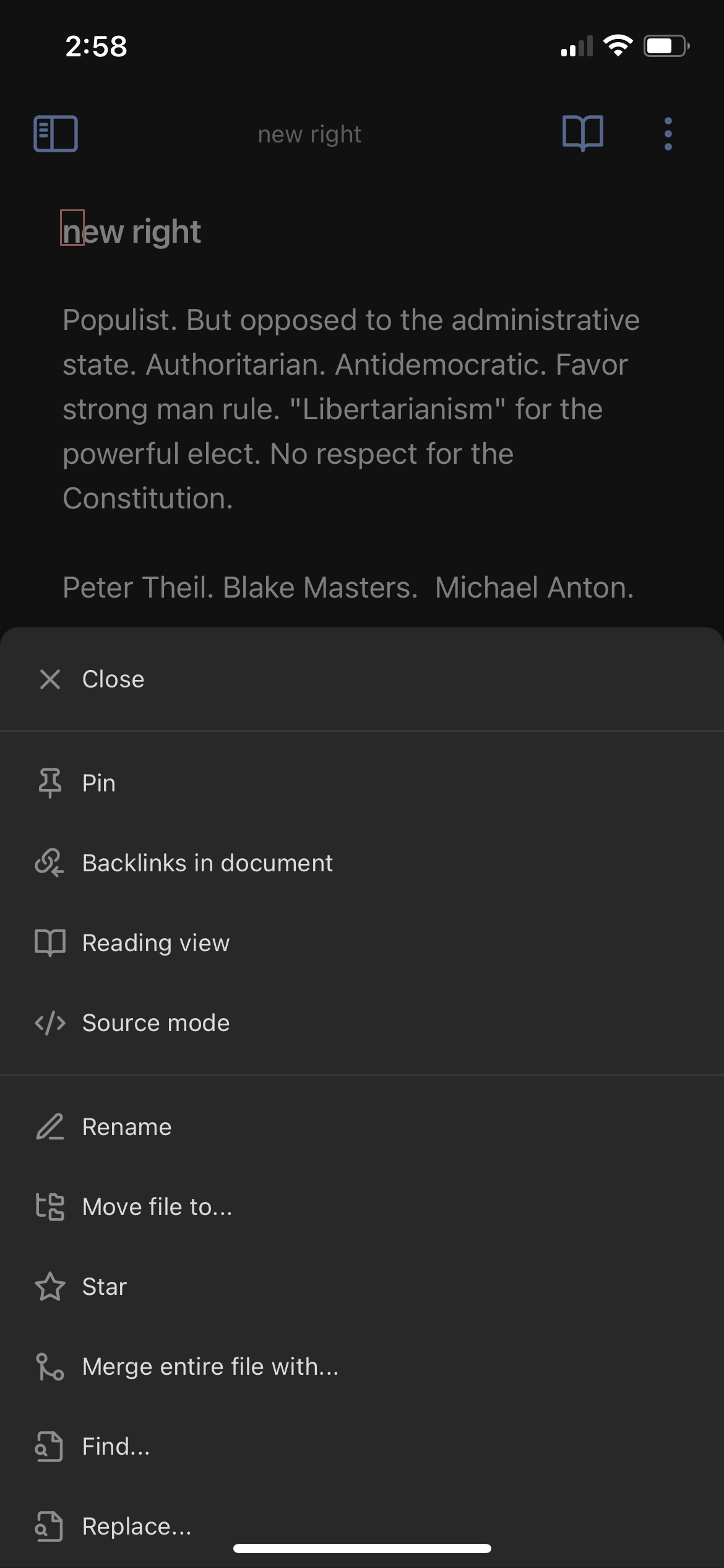

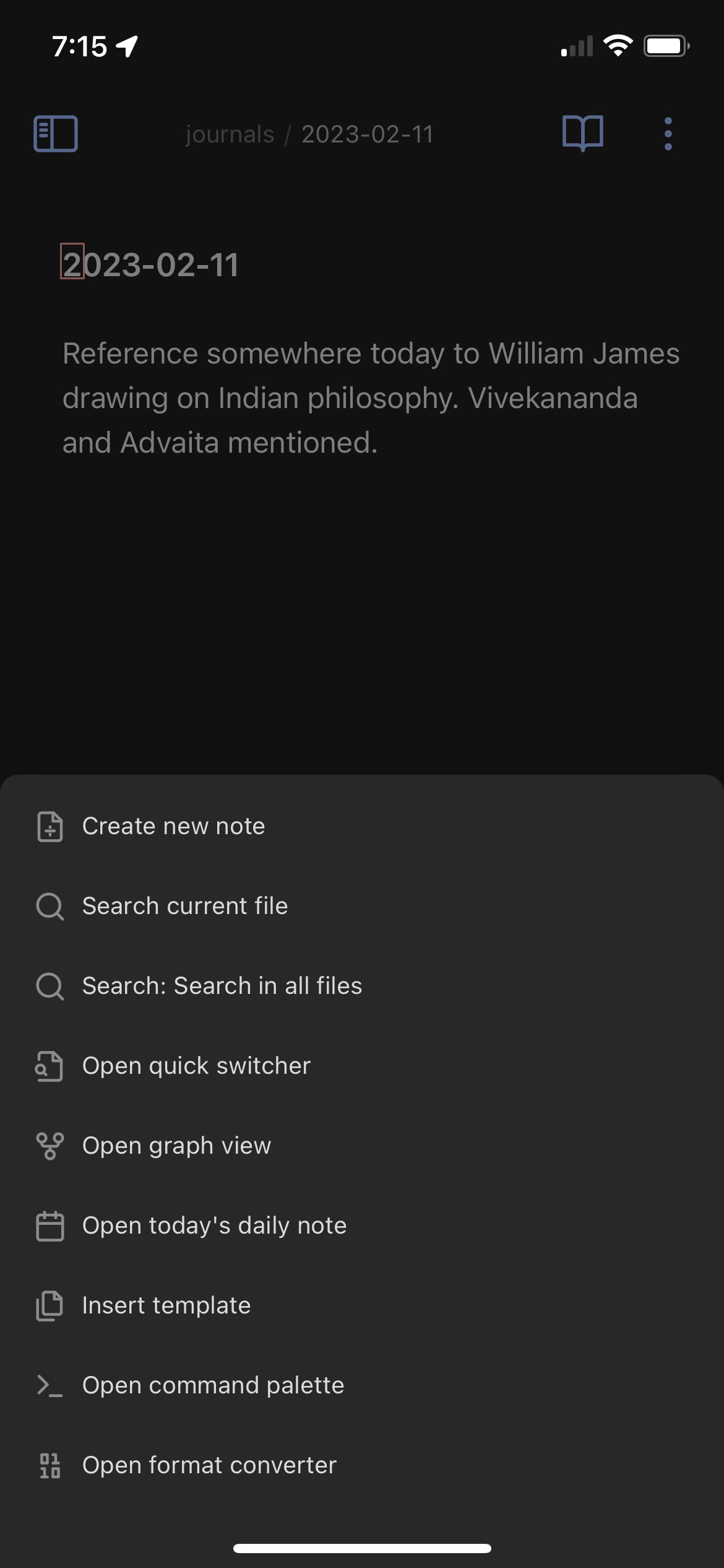

Asking about are the lists of commands accessed via the three stacked dots in the upper right corner and the three stacked bars in the lower right corner when a note is open. I’m attaching screenshots showing the lists of commands provided by each of them.
Commands accessed via three dots:
Commands accessed via three bars; I’m especially interested in these.
I got your requirement. But I am not aware of a method customizing them. And I think they are default. (Cannot be changed).
However, the three options I gave you will be OK. I think.

The commands accessed via the lower right corner can be modified via Appearance > Ribbon menu. Click Manage and adjust it to your needs.
Thanks. That’s what I was looking for.
