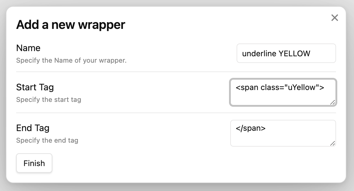

And you could use the plugin wrap with shortcuts to make commands and hotkeys for wrapping the selected text in the span classes:
