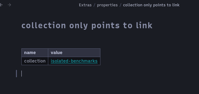

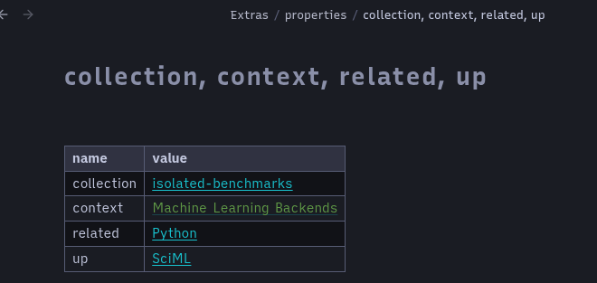

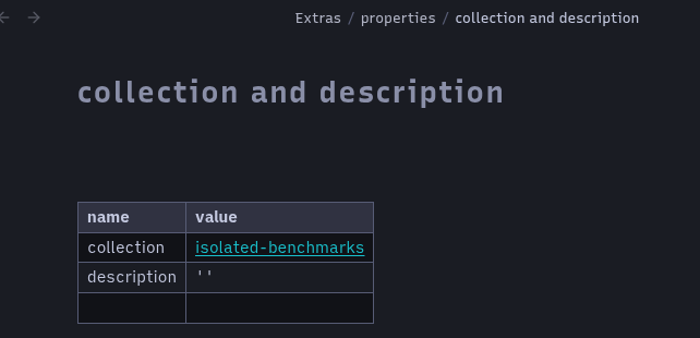

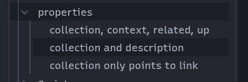

You define the property, or properties, inside a table in a “property note”. I chose Extras/properties to add as many notes as I need.
The properties note will look like this:
or
or

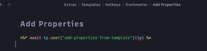

This is how you call the templater note:
<%* await tp.user["add-properties-from-template"](tp) %>

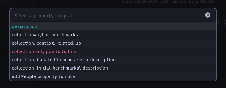

Assign a hotkey to the templater note, something like Alt+P. Then, in the current note, just press the hotkey, and select the property note you want to append to your frontmatter.
This is how the suggester would look after adding property-notes with their respective property:value pairs tables:
