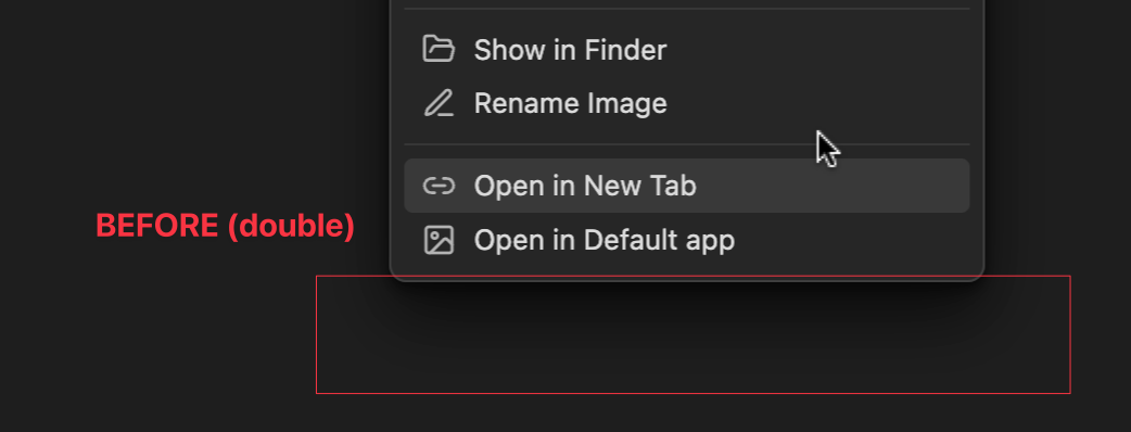

Duplicate context menu when NOT using native menus (appears twice, layered on top of each other)
Affected platform
  • Obsidian 1.8.7–1.8.9
  • macOS
  1. Start with a completely fresh vault (also works in the Sandbox)
  2. Set the Appearance → Native menus setting to OFF
  3. Install a plugin that provides a right-click context menu for images in Preview mode: I have tested this successfully with Pixel Perfect Image, Image Converter, Image Helper, and Image Context Menus. But I believe any plugin that uses the standard method of registerDomEvent(document, 'contextmenu' ... will experience this bug.
  4. Create a new note
  5. Paste in an image
  6. Right click on that image
You will see the context menu appear. Now, observe that it has a thicker/darker border/shadow effect. That is because there are TWO context menus stacked on top of each other. You can confirm this by tapping the ESC key to dismiss the top one, you will see the shadow lighten, and reveal the identical menu beneath it. Tap ESC again to close the 2nd one.
This bug does not seem to occur on Windows. Nor does it occur when Native menus are in use.
Yes
Single context menu appears when right clicking.
Two menus appear.
	Obsidian version: v1.8.9
	Installer version: v1.8.7
	Operating system: Darwin Kernel Version 24.3.0: Thu Jan  2 20:24:22 PST 2025; root:xnu-11215.81.4~3/RELEASE_ARM64_T6041 24.3.0
	Catalyst license: insider
	Insider build toggle: on
	Plugins installed: 1
	Plugins enabled: 1
		1: Pixel Perfect Image v1.0.10
Screenshots & Video
Here are a couple of screenshots showing the issue.
And here’s a screen recording:
Originally I had thought this was a bug specifically in the Pixel Perfect Image plugin (GitHub issue) so linking that for reference.
This is an issue with Electron v33 on macOS. We will be updating to a new version of Electron soon that addresses this problem.
Thanks @liam I thought I was going crazy at first.
There is an updated electron build in the insider discord channel. You can try that.
Indeed, the E34 build does fix this bug! Thanks @WhiteNoise for that tip. I don’t hang out in the Discord much (perhaps I should)
