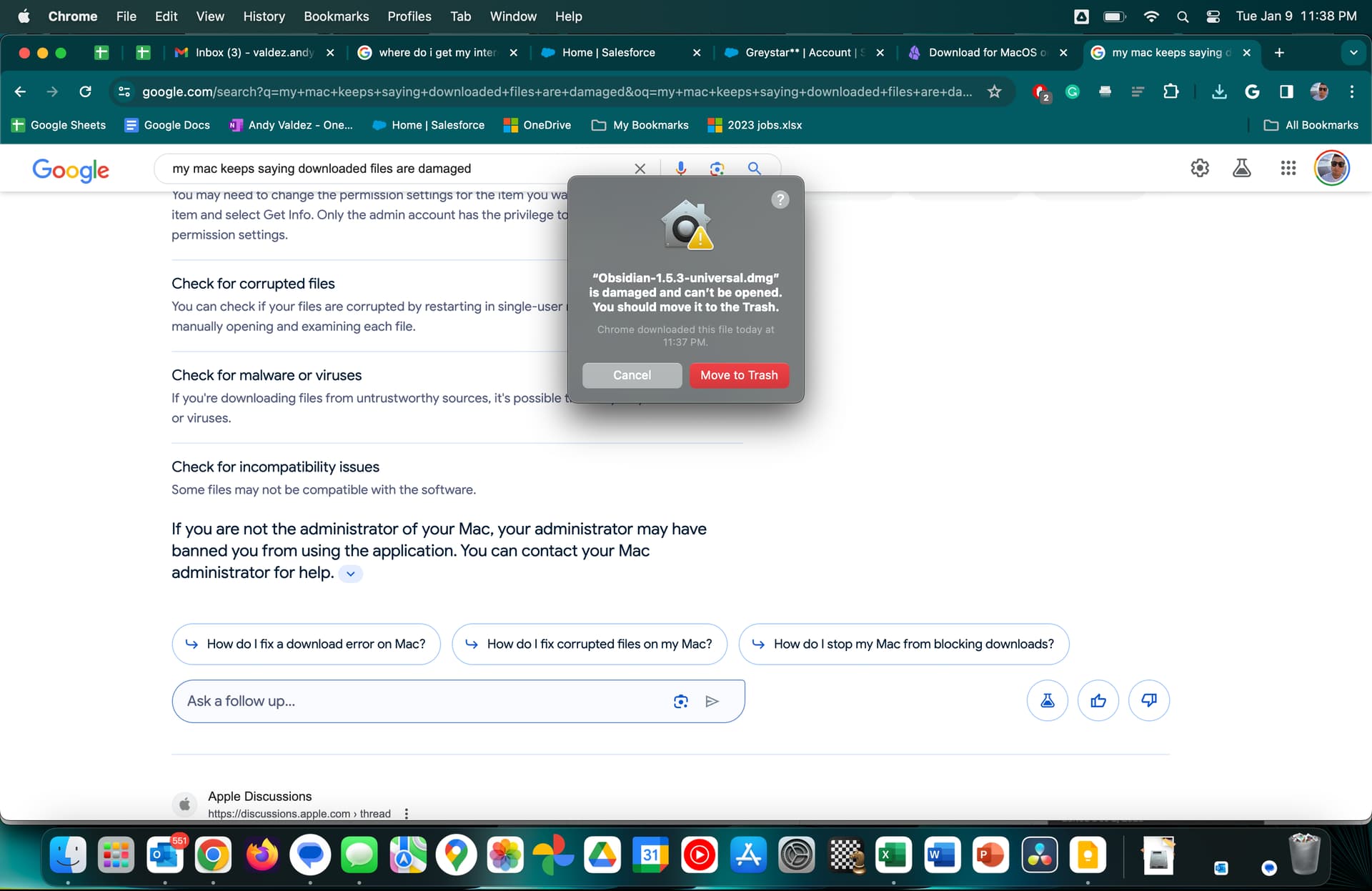

When I went to https://obsidian.md/ to download the program for Mac OS (I’m on M2 silicon) it downloads the program but each time it says the file is corrupt and I can’t install it.

Hey, thanks for trying to help troubleshoot. I downloaded it through Chrome and just tried through Mozilla but still no success. I had also tried the universal version and one that was supposed to be for the M2 chips as well.

Indeed it’s strange, I just tried it again but no luck. This is after having restarted the computer too just in case.

Gentlemen & Gentleladies, I’ve got it working now! Not sure why it wasn’t working before but I just updated to Sonoma 14.2.1 and it finally works now!
