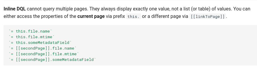

I think what you are looking for is not possible with an inline query. As per Dataview documentation

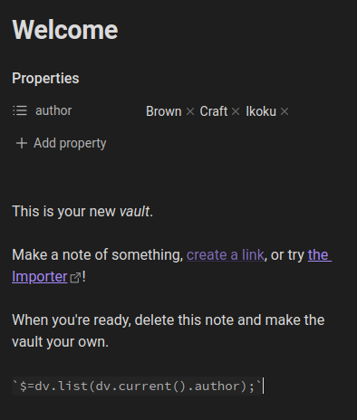

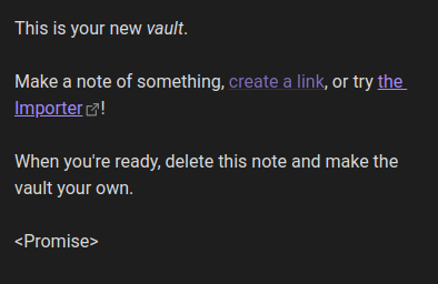

I tried this but I get a Promise.
`$=dv.list(dv.current().author);`

It’s kind of strange that you got a Promise out of that call, as it shouldn’t return that. If however it was meant to return that, like various Templater functions, you could use await in front to resolve the promise.

`$= dv.list(dv.current().Author) `
I tried await in all its imaginable variations.
Still doesn’t work.
I guess it is a limitation of inline JavaScript, if we follow the documentation. One line per response; no multiline.

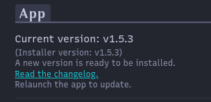

Which version are you currently on? Could this be related to 1.5.8 which I’m having large issues with currently? (Not this issue, but other stuff).
But there is no problem having dataview return multiple lines of response using inline queries. I daily build large group of objects both in my test vault and personal vault, so your issue is related to your setup somehow.
I am in 1.5.3
EDIT
Correction: 1.5.8
I relaunched and automatically upgraded to 1.5.8.
The problem presents in 1.5.3 and 1.5.8.
Tested in a clean, brand new vault, but 1.5.8

<Promise> on my dv.view one-liner (unrelated to this thread) as well (1.5.3).
If I await it, all I get is a - on that line as result.
