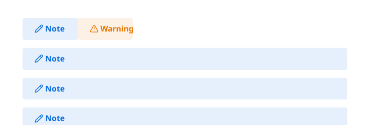

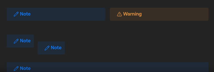

I have made my own CSS with which I can create a simple grid within a callout (which you can find on my GitHub: obsidian-snippets/callout-grid.css at main · lajawi/obsidian-snippets · GitHub). I expected the custom styled callouts to export correctly, but all grid styling is lost (aka display: grid; doesn’t seem to work for PDF exports).
I have tried other’s grid solutions too, like for example this one: Obsidian Grid Callouts · joschua.io, but even then no luck.

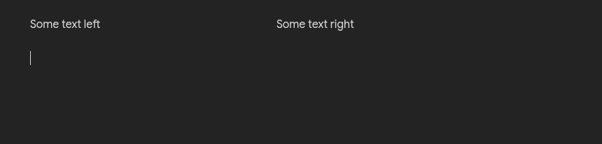

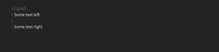

Source mode
Live preview
Reading view

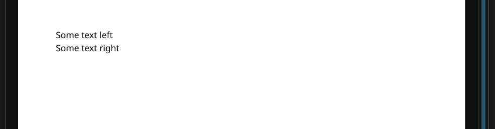

Exported PDF
Goal
Exporting a PDF that has the same layout as in live preview and reading view.

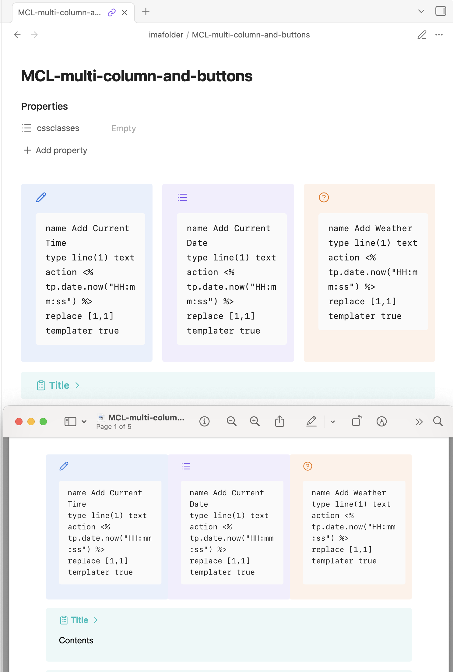

efemkay’s solution doesn’t work completely as expected in exports either (left is live preview, right is exported PDF):
What I did notice however, is that they use display: flex; instead of display: grid;, except if you set a specific column count with provided metadata “classes”. If you do that, the exact same behaviour can be observed as in my OP.
