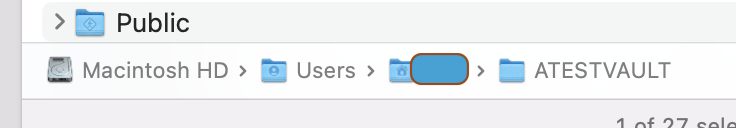

There is no code to input. I was suggesting moving your Obsidian vault in iCloud Drive to this location Users/USER/{VAULTNAME} on your mac. This will remove it from iCloud Drive on the iPad as well.
If there is an Obsidian vault in iCloud Drive, it will also be on your iPad in iCloud Drive. It will look like this in the Finder on your mac:
Screenshot 2023-11-20 at 16.47.58
You could move it to here on the mac. Moving it to here, for example, will remove it from the iPad after a bit of time.

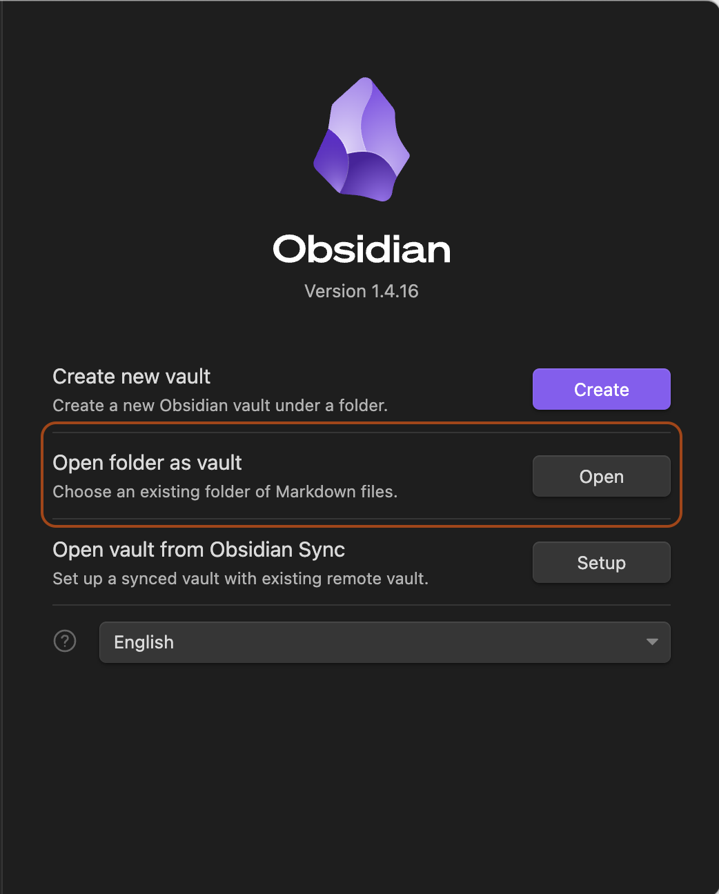

The best way to move a vault is using Obsidian’s vault switcher. Right click on the three dots next to the vault name and Move vault…
This way Obsidian will remember the location of the vault. If you move it outside of Obsidian using the Finder, you will need to point Obsidian at the new location using Open folder as vault in that same window:
