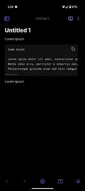

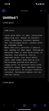

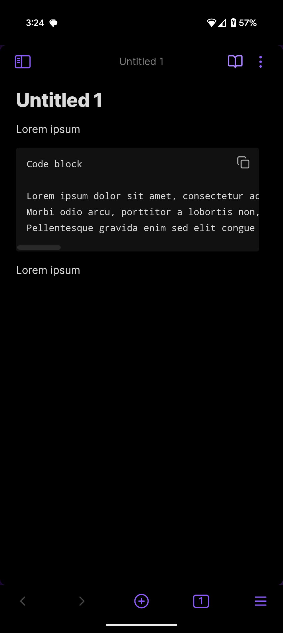

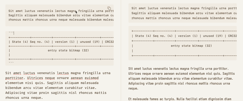

I tested on an Android just now, and it looks like this in the default theme…
Reading:
Source mode (it’s awkward in this mode, sorry!):
Without the snippet:

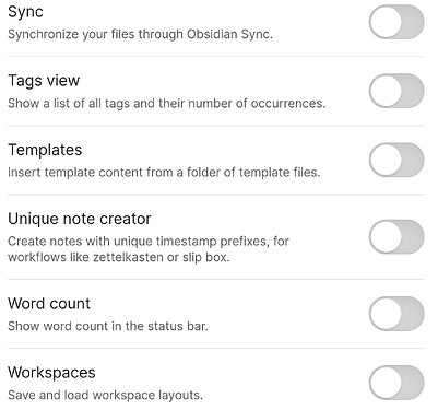

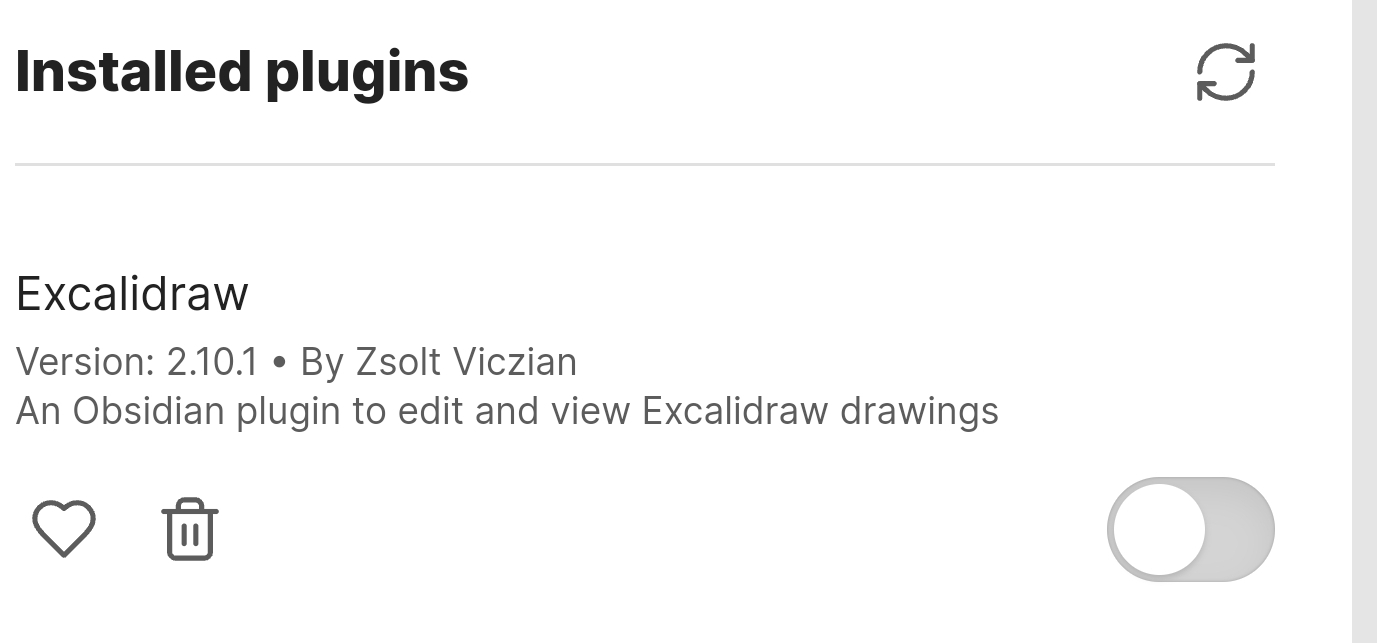

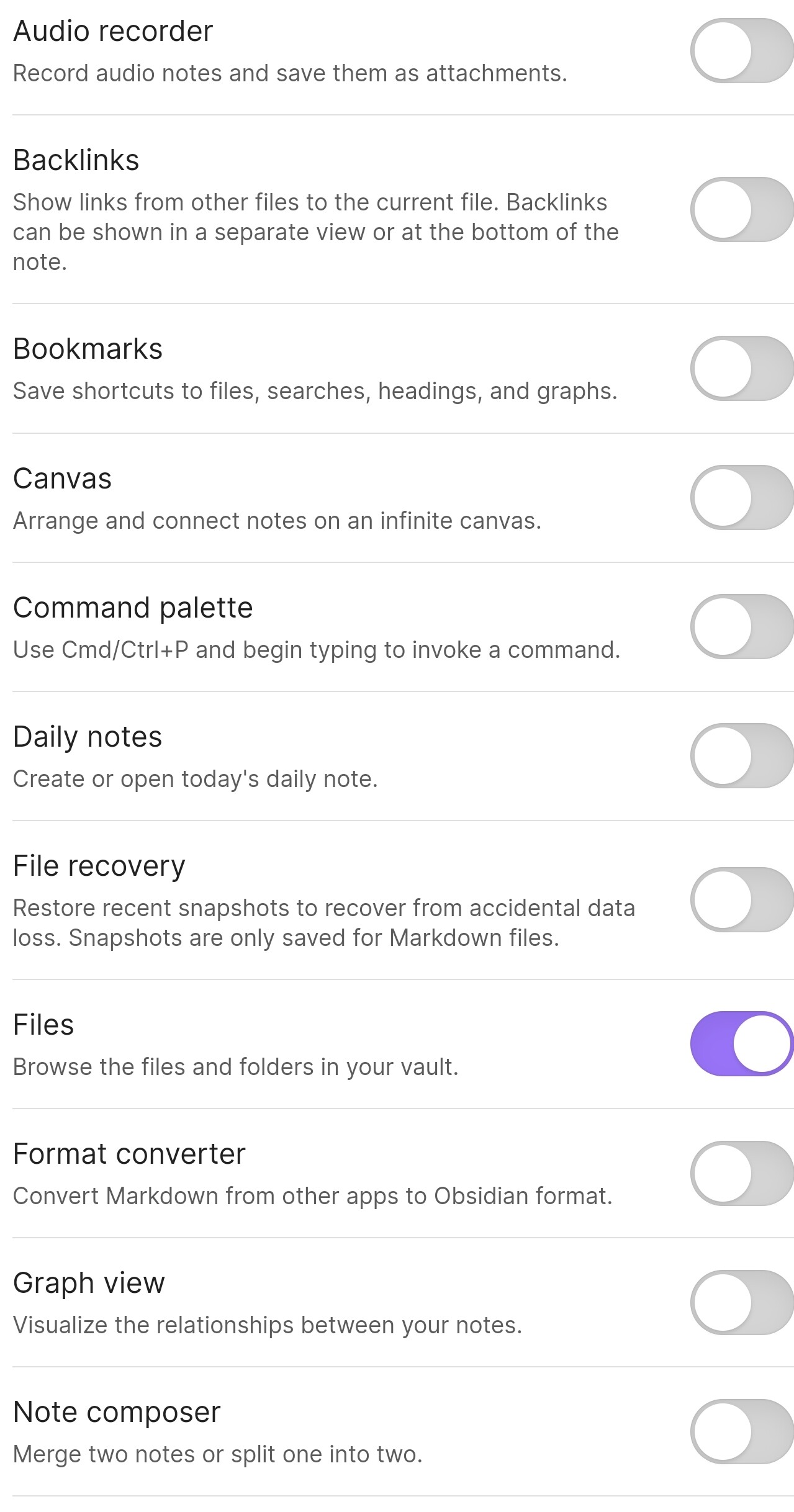

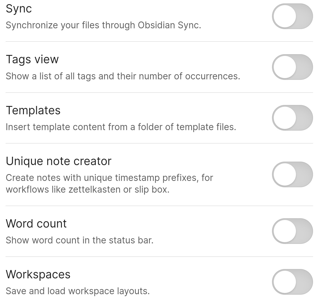

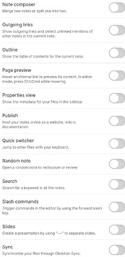

I have the following core plugins installed(see images):

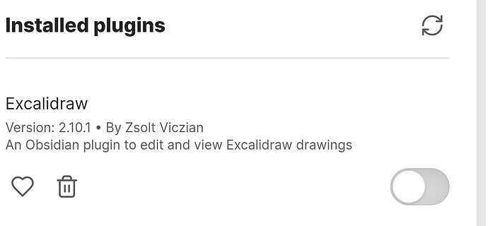

and one community plugin installed(see image):

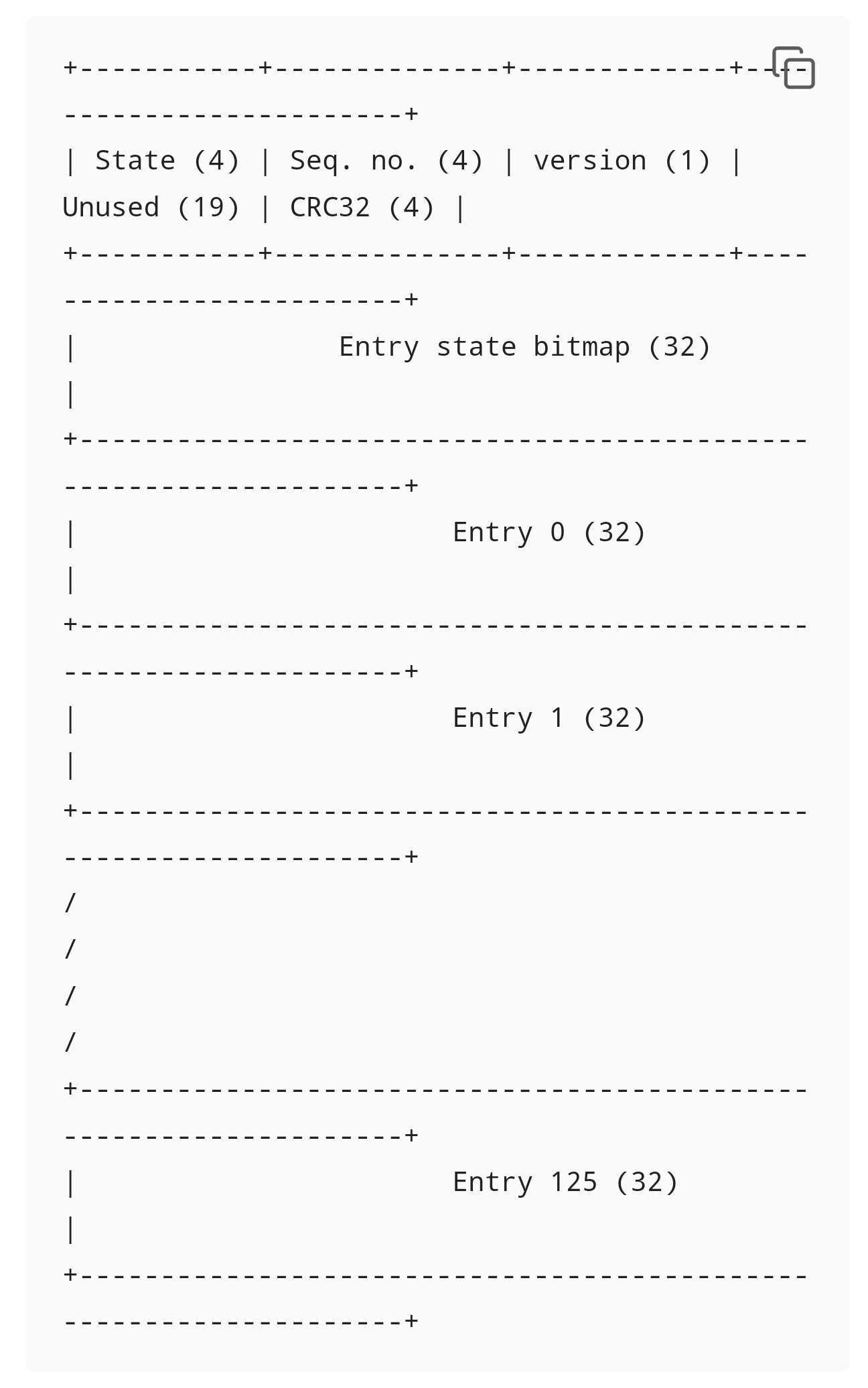

As you can see, I disabled almost all plugins during my experiments with snippets. I tried turning various settings on and off and rebooting the application. Try to set the default theme. But I have failed to achieve the same visualization of code blocks as in your picture. This is how the code block is displayed in the app on my smartphone:

I can confirm that dawni’s snippet is working for me on macOS and iOS.

Also, what language have you assigned the code block (if any)? I noticed some different (and odd) behavior depending on the language set.

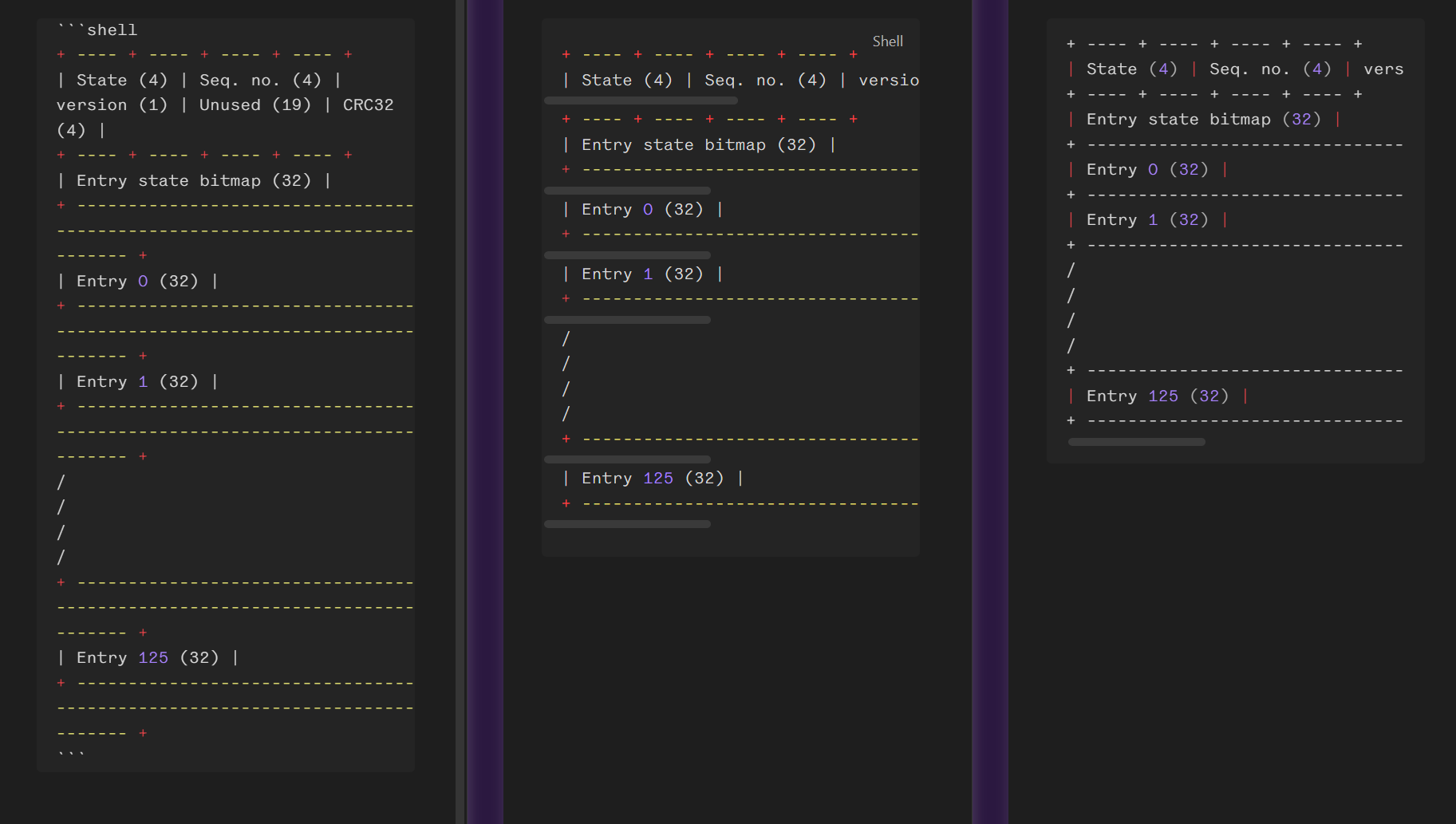

Oh, I think see what’s up. It has to do with what ariehen said about the code block language. Try this to see if it captures all languages for you in Reading and Live Preview:
/* scroll code blocks in reading view */
code,
code.language-shell.is-loaded {
	text-wrap-mode: nowrap;
/* scroll code blocks in Live Preview */
.markdown-source-view.is-live-preview .HyperMD-codeblock-bg:not(:is(.HyperMD-codeblock-begin, .HyperMD-codeblock-end)) {
	display: block;
	overflow-x: auto;
I get this result in (from left to right) Source mode, Live Preview, and Reading:
To apply it to Source mode too, delete .markdown-source-view.is-live-preview .
