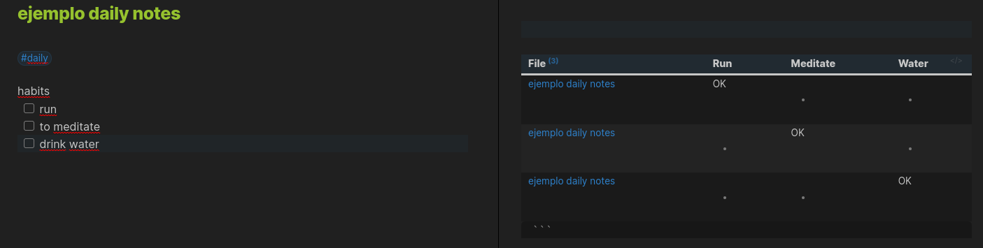

It doesn’t work for me, it looks like this:
TABLE runC as Run, meditateC as Meditate, waterC as Water
FROM #daily
FLATTEN file.tasks as task
WHERE any(map(list( “run”, “to meditate”, “drink water”),
(m) => contains(task.text, m) ))
FLATTEN choice(contains(task.text, “run”), “OK”, “-”) as runC
FLATTEN choice(contains(task.text, “to meditate”), “OK”, “-”) as meditateC
FLATTEN choice(contains(task.text, “drink water”), “OK”, “-”) as waterC
There are 2 things I need help correcting.
rows first:
You see 3 lines on the same page, the idea is that you see a single row per date. So:
second:
It does not work when completing the task it does not change to ok. The idea is that when completing the task, ok can appear and if not, it says no or something like that.
Both of your issues are related to the FLATTEN file.tasks as task in my original query, which splits out the tasks into their separate items. Aka make three rows for each attribute you want to track. To handle that we either need to start doing any(map(file.tasks, ...)) stuff, or do some other magic to regroup the result into a single line again by doing GROUP BY file.link and some extra magic to collate the result.

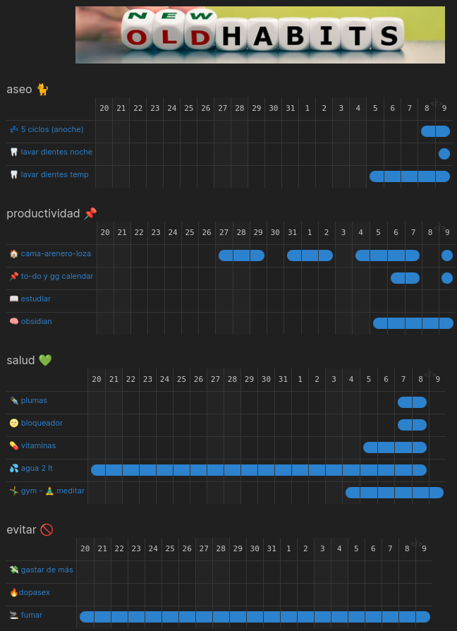

Have you scanned the community plugins for alternative tracker plugins? There exists a whole lot of them with different focus. Just for the fun of it I installed the Habit tracker 21 plugin, and created the files “Habits/run”, “Habits/to meditate” and “Habits/drink water”, and ran the default variation over it (and clicked on various days in the table) and it displayed this table for me:
That’s kind of nice variant I think, and it’s easy to see streaks and correct if you did or didn’t do a habit the previous day(s) or not. I’m actually considering whether I’ll start using this in my own vault! :smiley:
Indeed the plugins saved me. It looks amazing and I was able to add icons and group by type of habits. so I remain:
Thank you very much for the help, the plugin was a good recommendation.
