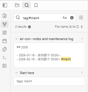

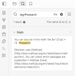

Both inline tags and tags in Properties officially apply to the entire note, but when using the Search tab or embedded queries, you can see the context of where the tag is in the note. I find this really useful.
Search tab and context →
Embedded query and context →

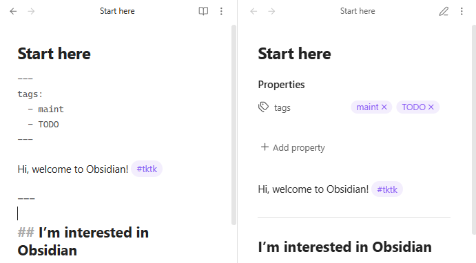

Most of my inline tags are verbs - some action to take in that section of a note: #to-check, #revise, #tktk (come back here!), but there are some nouns as well to mark a spot in a section/note: #maint for maintenance matters around the house and office, etc.
I should also mention that inline tags start with a #. You don’t need to type this when adding tags using the metadata editor interface (“Properties in document”):
source mode | reading view
https://help.obsidian.md/tags
