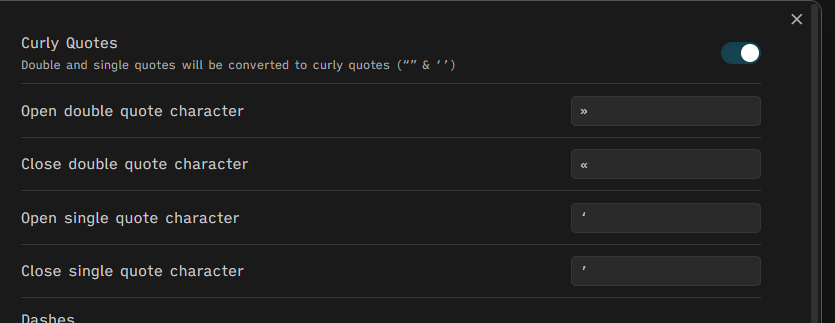

This thread mentions »German« inward-facing guillemets. Are your settings in line with the answer given in the thread? (I expect they are, but …)

well, I have the guillemet » in the plugin settings for open double quote and the « for close.
