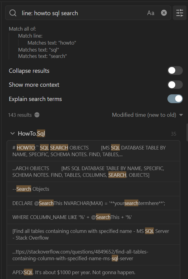

I read that, but it doesn’t seem to behave that way. Maybe I have a setting I have accidentally done.
For example the image below… it has a bunch of stuff that doesnt include the search terms?
Sorry for being unco if that is the case :expressionless:
If I’m not mistaken, search terms are separated by spaces — so your example just searches normally for those 3 words. I think you need to group them: line:(apple orange pear). That’s why I included the opening parenthesis in my bookmark example.
ahh ic, thanks CawlinTefffid…
Line:(apple orange pear) indeed does the trick…
