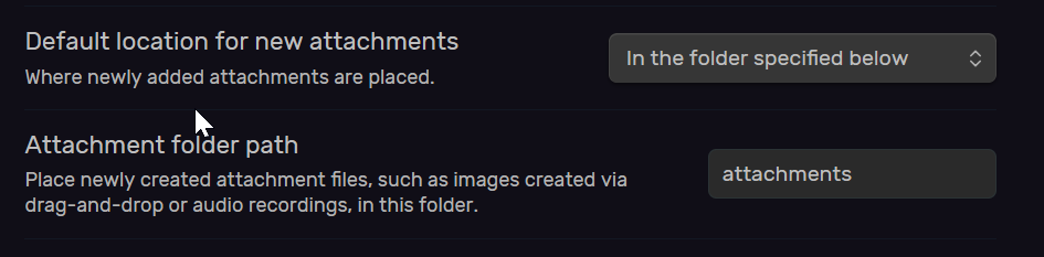

This problem REAL:
When type:
and then open again:
Again, and again…
I tested with variuos theme.
And nevermind or folder created or not, not save.
I think this bug: not saving with parametr: IN THE FOLDER SPECIFIED BELOW
Other parametr work fine.
This original bug report (about In subfolder under current folder) was fixed in obsidian 1.7.4.
@Aurelijus you need to pick a folder that already EXISTS for “in subfolder specified below”.
Thank You for Your time! but…
Won’t working in this video-screen
Not working on 1.74 version
Any ideas?
