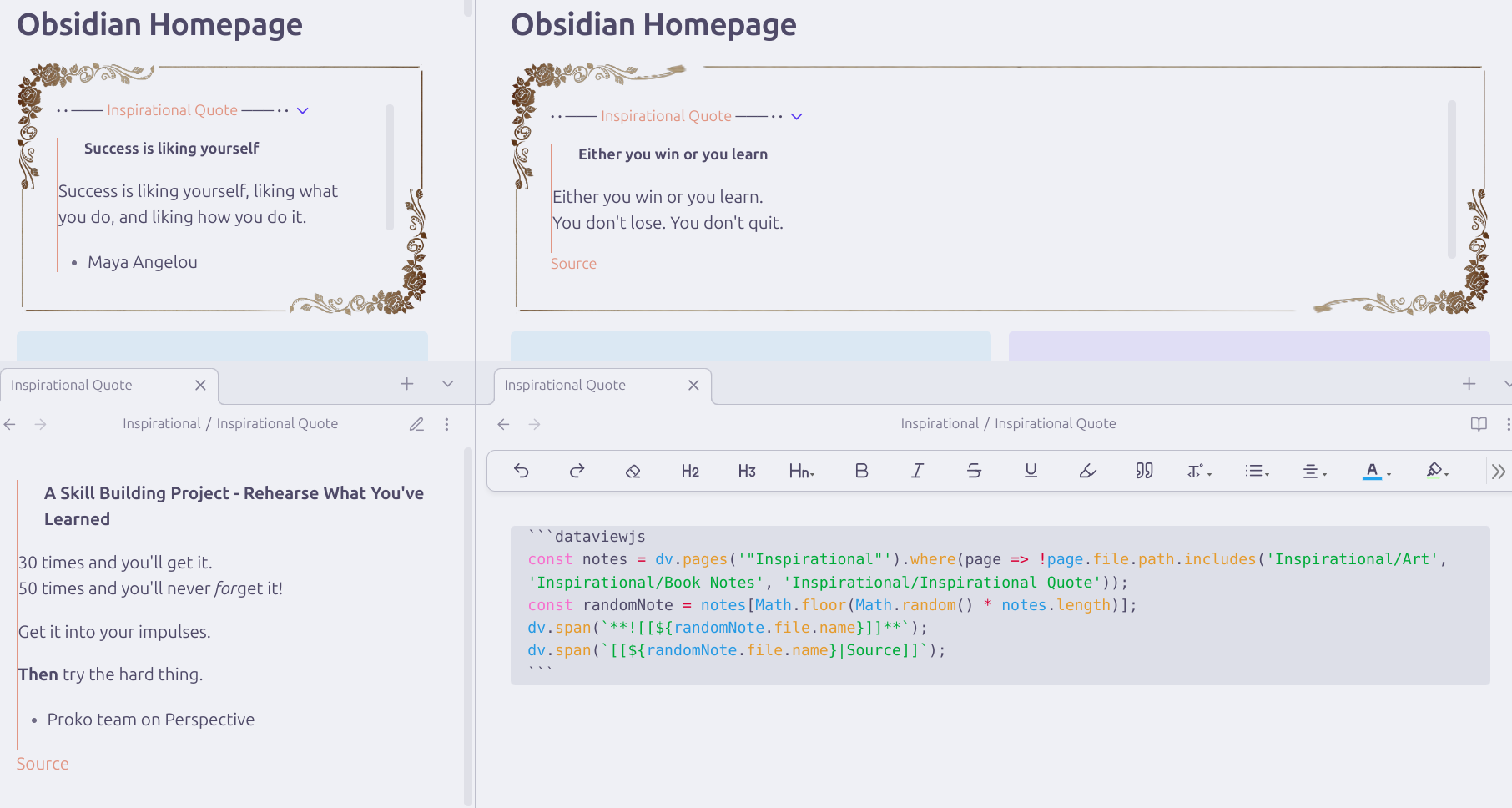

Hello, I would like to rewrite my dataviewjs script to pull only from a subfolder, not any notes from the main folder or other subfolders. I have this setup for inspirational quotes to randomly appear on my homepage and I thought I’d like to see art appear as well (on another page I’ll have in the sidebar). Here’s my current setup, with examples of the random output.
“Homepage” file has a custom callout that has an imaged Wikilink to the “Inspirational Quote” file which has a dataviewjs script that pulls random notes from my “Inspirational” folder, except the “Inspirational Quote” file itself, and now two subfolders (might be convoluted but works for me!).
const notes = dv.pages('"Inspirational"').where(page => !page.file.path.includes('Inspirational/Art', 'Inspirational/Book Notes', 'Inspirational/Inspirational Quote'));
const randomNote = notes[Math.floor(Math.random() * notes.length)];
dv.span(`**![[${randomNote.file.name}]]**`);
dv.span(`[[${randomNote.file.name}|Source]]`);
I had written this script using AI, begrudgingly, because I don’t know Javascript well and Google is not what it used to be… (I think I referenced this forum at the time, too.) I still had to use multiple prompts from a couple AIs, and frankenstein the result to this (and look up how to use span since neither OpenAI nor DeepSeek gave that).
Now I want to rewrite this script to pull only from the “Inspirational/Art” subfolder. I messed around the first line and I just can’t seem to do it myself, I don’t know where I’m going wrong to only get errors. And AI is no longer free to prompt over and over, and Google is still as frustrating as ever now.

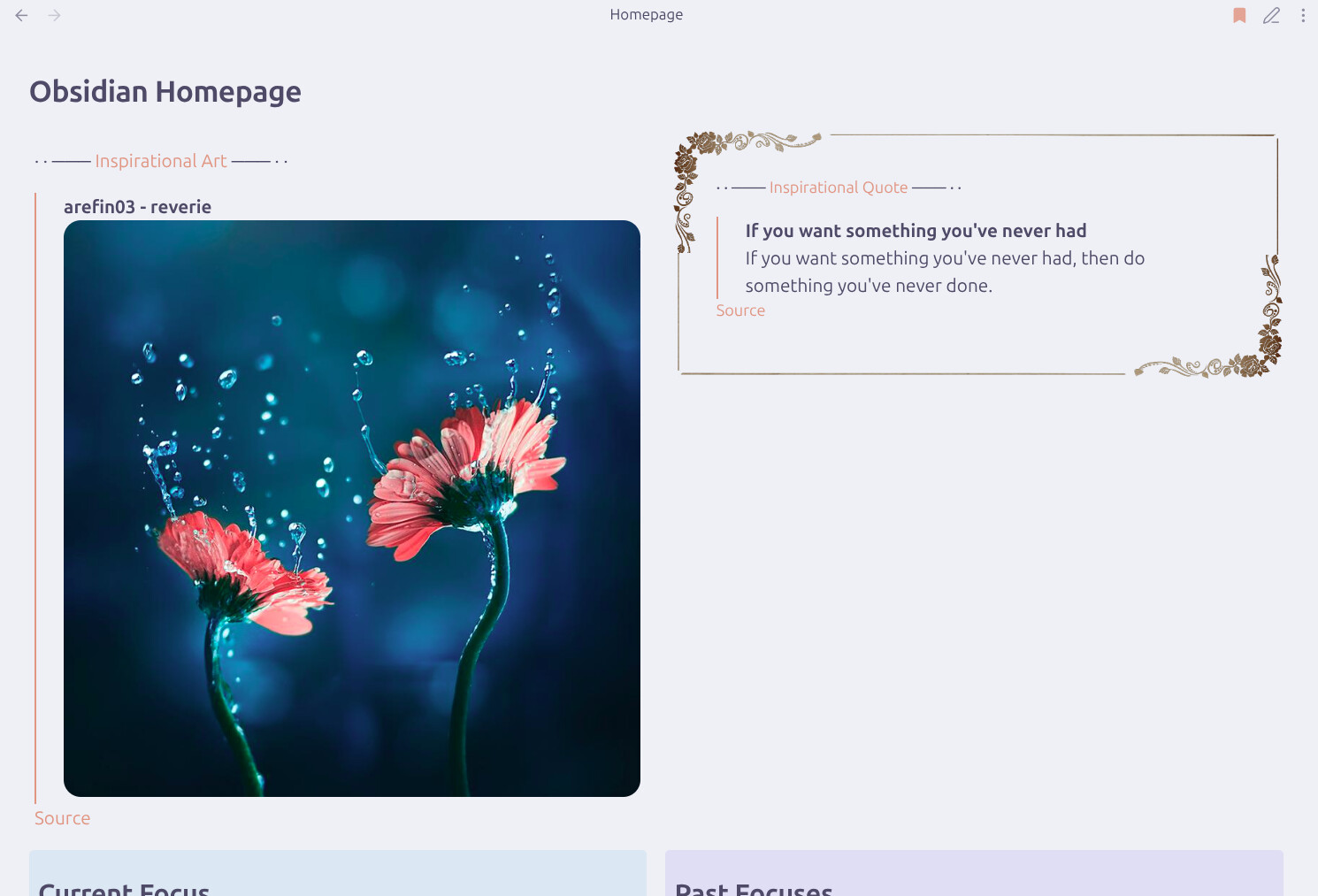

Here’s my end result for anyone curious :glowing_star::
>[!blank|float-left-medium-50]
>· · ─── [[Inspirational Art]] ─── · ·
>```dataviewjs
>const notes = dv.pages('"Inspirational/Art"').where(page => !page.file.path.includes('Inspirational/Art/Inspirational Art'));
>[!roseframe|50] · · ─── [[Inspirational Quote]] ─── · ·
> ```dataviewjs

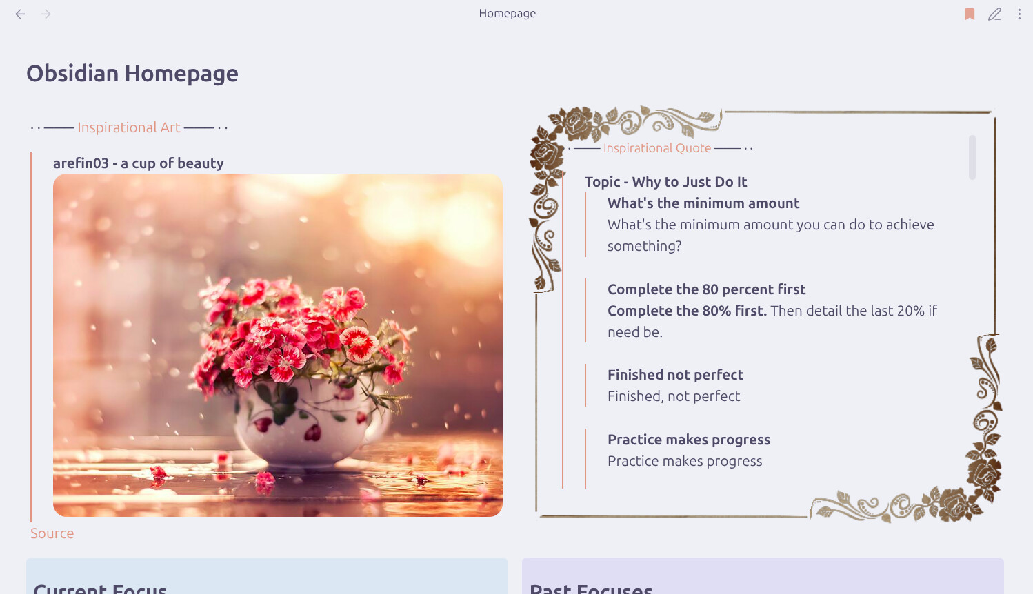

I like it! Currently, some of the functions are are not working. The 50-length scrollable metadata is not working for the Art container, only for the rose frame. Might be a fault of the blank callout.
For some reason the folder and file exclusions don’t work for the Art side and stopped working for the Quotes side… Not sure if I put one too many exclusions? Or messed up the syntax a tad? Perhaps rearrange quotes or commas some more? Not sure. So at the moment the quotes box is pulling from the art subfolder as well…
Maybe I’ll give up and throw all the quotes in a subfolder as well, so I can erase the “.where” exclusions altogether… That sounds like best for now.
Lastly, this layout does look more janky when the size of each side doesn’t match up.
Not much I can do about that, haha

Okay, I should’ve had quotes in a subfolder ages ago. Much neater for a few of my overhead files to be separated from them, too! Here’s the resulting script:
>[!blank|float-left-medium]
>```dataviewjs
>const notes = dv.pages('"Inspirational/Art"');
> ```dataviewjs
> const notes = dv.pages('"Inspirational/Quotes"');
