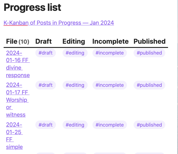

Here’s the ‘wrong’ result:
I imagined that I would see the file name and then in a column #draft or #incomplete – but not all.
You’re still not presenting a typical part of a file , with explanations on what you expect. The wrong output is not helpful as it only displays the literal values from your query.
You’ll most likely need to check the file.etags or fike.tags using one of the contains() methods, but this a somewhat basic query so there are plenty of examples in this forum on how to do this.
