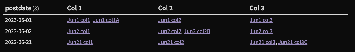

I’m trying to use dataview to create a table exactly like this one:

The trick to this kind of output is that to find something common to group by, aka postdate, and then for each of the columns select the relevant entries in the rows array.
This results in a query like the following:
```dataview
TABLE
  join(filter(rows, (r) => r.channel = "SLSYT").file.link, ", ") as "SLSYT",
  join(filter(rows, (r) => r.channel = "SLSI").file.link, ", ") as "SLSI",
  join(filter(rows, (r) => r.channel = "SLII").file.link, ", ") as "SLII",
  join(filter(rows, (r) => r.channel = "SLSTT").file.link, ", ") as "SLSTT"
WHERE channel AND postdate
GROUP BY postdate
From a similar test run in my test vault I got this output:
If you leave out the join(), you’ll get lists of each result (most often possibly with only one item)
