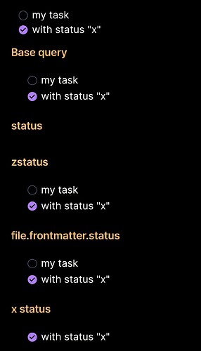

Try the following in a file of its own:
Zstatus: InComplete
status: InComplete
- [ ] my task
- [x] with status "x"
## Base query
```dataview
Task
Where file = this.file
## status
```dataview
Task
WHERE status = "InComplete"
## zstatus
```dataview
Task
WHERE zstatus = "InComplete"
## file.frontmatter.status
```dataview
Task
WHERE file.frontmatter.status = "InComplete"
## x status
```dataview
Task
WHERE status = "x"
This file in reading view displays as the following for me:
Explanation:
  • status in a Task query refers to the character within the square brackets
  • zstatus doesn’t have a special meaning so it refers to the frontmatter field of the file
  • file.frontmatter.status specifically targets the frontmatter variant of the status field
For other implicit metadata of a Task query see Metadata on Tasks and Lists - Dataview
Sorry for not catching the special meaning of status in a Task query earlier, it just slipped my mind.
