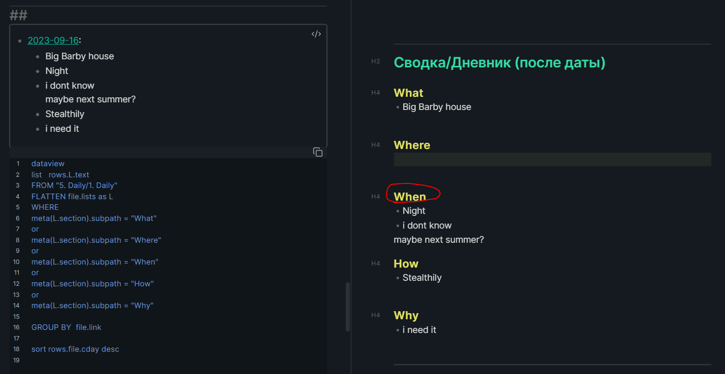

[Dataview] - List files with their titles (and show it)
Need to modify this request to display the headers before the response.
<= On the left, there is a demonstration of the current code implementation, and the code itself is below. <=
=> On the right, there are the input data. =>
list   rows.L.text
FROM "5. Daily/1. Daily"
FLATTEN file.lists as L
WHERE
meta(L.section).subpath = "What"
or
meta(L.section).subpath = "Where"
or
meta(L.section).subpath = "When"
or
meta(L.section).subpath = "How"
or
meta(L.section).subpath = "Why"
GROUP BY  file.link
sort rows.file.cday desc
What I expect
If there’s no way to do it like that, perhaps there’s a way to present it in the form of a table?

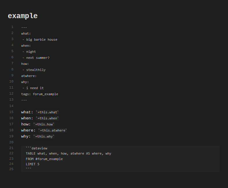

I would put this sort of data in yaml:
note where is a reserved word so I’ve called it atwhere
No, I specifically want to enter data through paragraphs.
I know how to do it using inline field or YAML, but it’s inconvenient to enter there because you are limited to one line
oh I see.
Well, it’s not perfect but you can use
GROUP BY meta(L.section).subpath
instead of
GROUP BY file.link
to make a single note work.
I think I would head to dataviewjs for something more complex.
To get two levels of indentation in a list you do need to use dataviewjs, I think, and there are examples of such here in the forum.
To get the lists in a table format, you might do filter(rows.L, ...) to separate out the various sublists.
