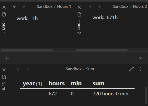

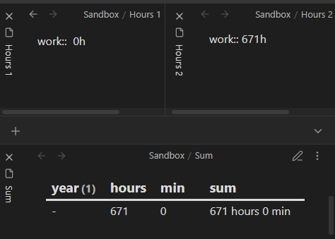

I’m not sure, but it seems that with the second way it starts to happen when THE SUM is bigger than 671. And with the first method, when ONE OF THE VALUES is bigger than 671. That’s probably why I didn’t notice it earlier. I’m usually adding values around 160–180 hrs a month. So, with the first formula, it’s not visible with my data, but with the second method, the problem starts to occur after summing up a few months of work. Any help in understanding this will be greatly appreciated.

The two numbers you’re seeing are the number of hours in a month, but in shorter and longer months:
28 days ( 24 hours / day ) = 672 hours
30 days ( 24 hours / day ) = 720 hours
It seems the sum function returns “1 month” at 672 hours. But then the durationformat function receives that “1 month” duration and translates it as 720 hours. I tested various units, sums, and formats and consistently saw the same behavior, unfortunately.
