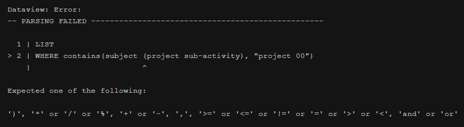

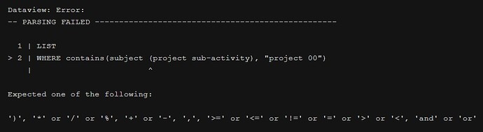

WHERE contains(subject (project sub-activity), “project 00”)
… and everything works fine, but with parentheses in the property name dataview gives an error:
I tried enclosing subject (project sub-activity) in:
  • [] (including using econtains instead of contains (because the dataview documentation used square brackets in econtains, not contains))
… but it didn’t lead to any result - only errors.
