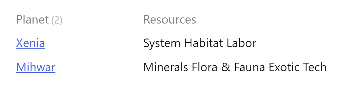

@ahmaddialdin, to get rid off blank fields in output table, replace this line:
), ", ") as Resources with this ), " ") as Resources :wink:
Thanks @sysbreaker. Yup, it gets rid of the blank fields, but leaves the entries all as one continuous string:
Shooting for the stars: just trying to figure out how to delimit between them with commas or so on.
Haven’t found the right combo of nulls and nonnull or map or filter, etc. yet… half the fun is the trial and error, but need to look at it some more.

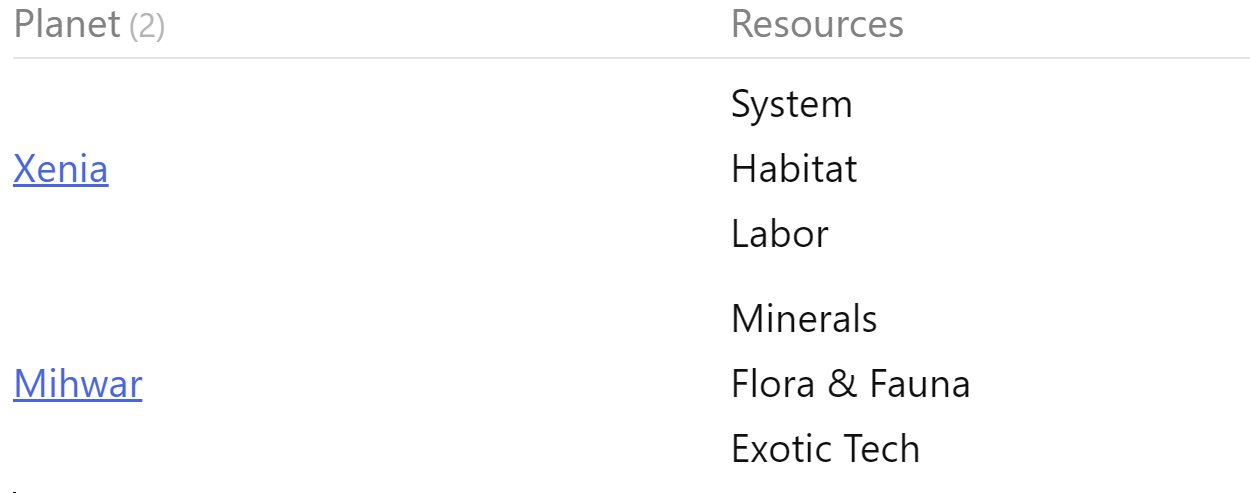

Your timing is uncanny… I had just finished testing out an array version of that (basically sans join function):
TABLE WITHOUT ID
file.link as Planet,
  nonnull(list(
    choice(hasSystem, "System", null),
    choice(hasLocation, "Location", null),
    choice(hasExoticTech, "Exotic Tech", null),
    choice(hasRuins, "Ruins", null)
    )) as Resources
FROM *path to folder*
So I love having both options working… thanks to both of you for the quick and awesome problem-solving session today. Feels great that I learned how to manipulate dataview from what you guys showed me. Totally appreciate it!
