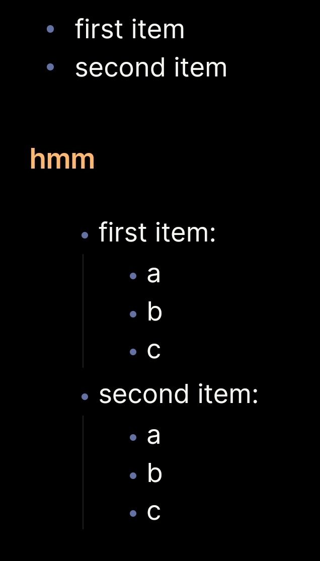

What do you get if you do the following in a file of its own:
- first item
- second item
## hmm
```dataview
LIST list("a", "b", "c")
FLATTEN file.lists as item
WHERE file=this.file
Group by item.text
This produces a multilevel list in my world (on mobile) like the following:

Ok, apparently that also created a list comma separated. The issue was that I had an option enabled on style settings plugin that created this behaviour (I’m on minimal theme).
Thank you
