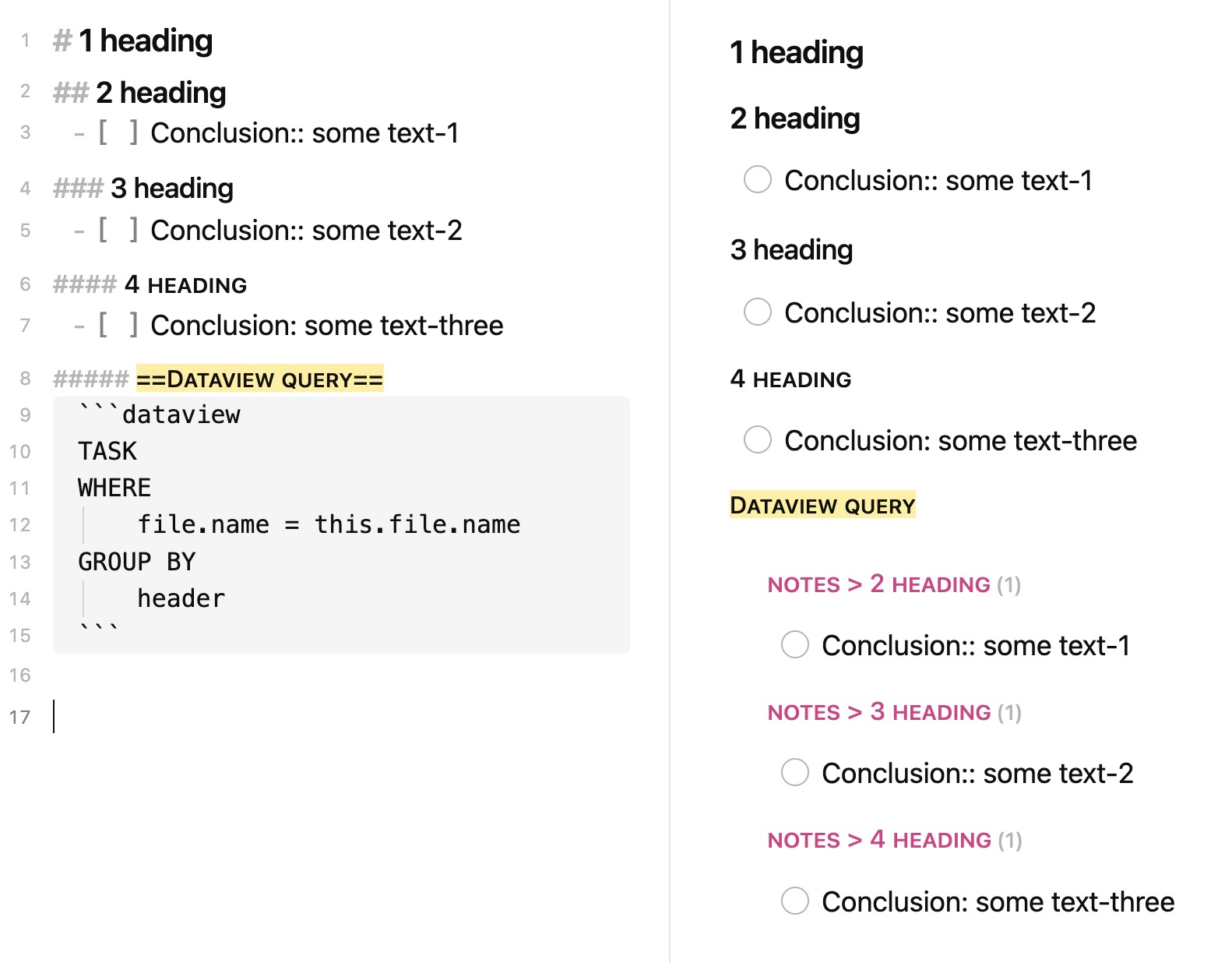

Seems to be possible if the Conclusions are tasks.
Someone else will probably have a better solution, but the text and query below work in local tests (use ‘paste and match style’ to preserve the layout).
# 1 heading
## 2 heading
- [ ] Conclusion:: some text-1
### 3 heading
- [ ] Conclusion:: some text-2
### 4 heading
- [ ] Conclusion: some text-three
#### ==Dataview query==
```dataview
TASK
WHERE
	file.name = this.file.name
GROUP BY
	header
A similar approach can be done using lists, but involves a little more mangling of data, as you need to grab a hold of the section link and manipulate that into using the section part.

Yeah I’ve decided to switch to using tasks as opposed in inline fields! I couldn’t find any other way around it.
Thanks for the recommendations! @holroy - It really helped target my search.
