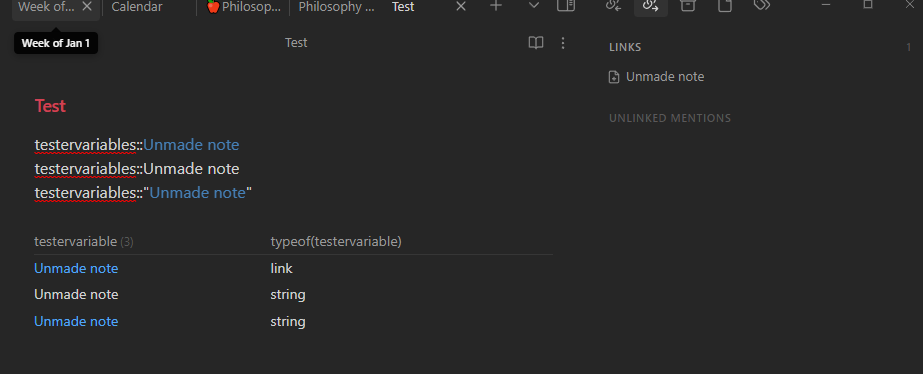

This illustrates how the various alternatives displays, and is treated by Obsidian.
As can be seen in the screenshot doing the unquoted “link format” produces a list of list, and not a link. This can also be seen by the double dot in front of the output, indicating the list of lists. Only the last option is considered a link by Obsidian, and only that one shows up in the outlinks/backlinks…
Thanks for this clarifying reply. I understand the difference now. I don’t currently use “Properties”, so all my fields are just added in the body of the note, and there, using showdate::[[2023-12-24]] is the only one that shows up as a straight link. If I use the quotes in a body-text field, it gives it as a string and doesn’t show up in the outlinks.

My bad, I’ve been answering so many questions on properties lately, that I missed out that you was using inline fields. Inline fields do behave like you say.
