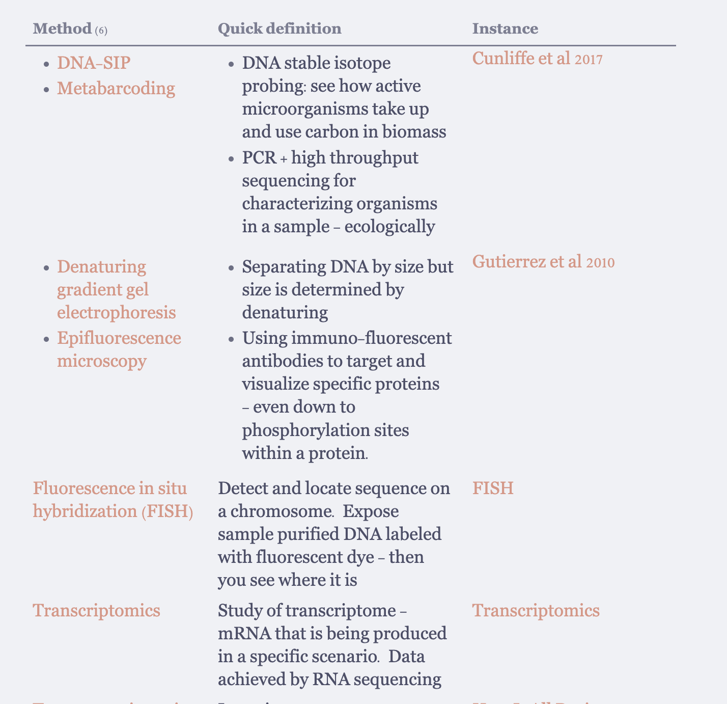

What I’m Trying to Do
I use dataview to collect terms across notes and store them in one place index/glossary style using this code:
 Dataview
TABLE WITHOUT ID Method, Process as "Quick definition", file.link as "Instance"
WHERE contains(tags, "Method") AND Method != null AND Process != null
SORT Term ASC
It works well except if there are multiple terms per note they become bulleted as you can see in the image. The terms also do not line up with the definition making it hard to read. How can I get the formatting consistent and get the terms to line up better? Also the asc sorting is only applied within a note (Cunliffe et al 2017 has D and M in order but we go back to D when starting Gutierrez etc)
Straight up omitting the file.link column to see if that would separate the terms. I do not necessarily need that column at all and would be happy to omit it, but we still get weird bullet points and not-aligned term/definition.
I am almost a complete beginner with no code experience.

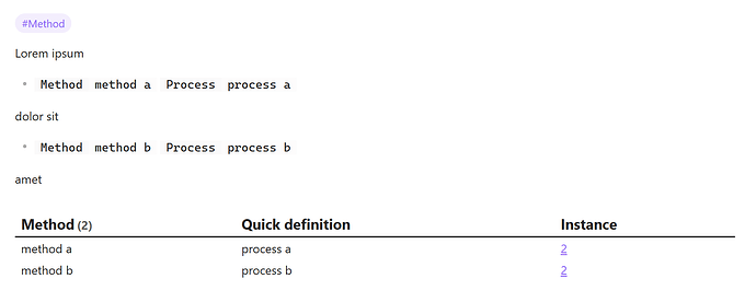

For inline Dataview fields, one way to explicitly pair your components is with list items:
Lorem ipsum
- [Method::method a] [Process::process a]
dolor sit
- [Method::method b] [Process::process b]
amet
#Method
… and a query like this:
```dataview
TABLE WITHOUT ID L.Method AS "Method", L.Process AS "Quick definition", file.link AS "Instance"
FROM #Method
FLATTEN filter(file.lists, (l) => l.Method AND l.Process) AS L
SORT L.Method
A drawback is that this method is incompatible with Bases.

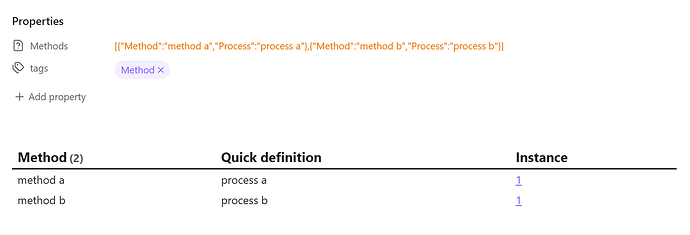

For front matter, one way is with objects:
Methods:
  - Method: method c
    Process: process c
  - Method: method d
    Process: process d
tags:
  - Method
```dataview
TABLE WITHOUT ID Term.Method AS "Method", Term.Process AS "Quick definition", file.link AS Instance
FROM #Method
WHERE Methods
FLATTEN Methods AS Term
SORT Term.Method
The drawback with this method is that Obsidian’s Properties widget doesn’t support displaying objects. You can enter the info in source mode, and Dataview (and Bases) can read it, but your Properties will have awkward orange text in Live Preview and Reading:
(There might be plugins that address that.)
