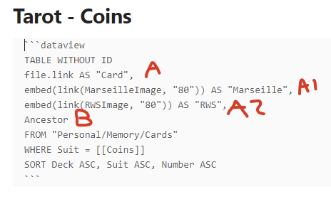

This query:

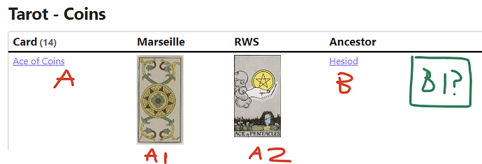

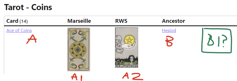

produces this table:

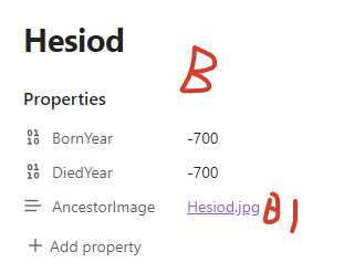

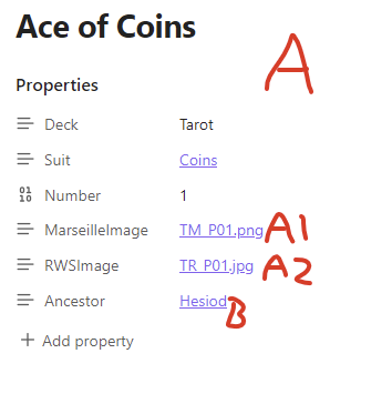

from this parameter data model:
… and what I want to get is the image B1 embedded in the table. Basically traverse the relationship from note A to note B and retrieve the linked image from there.

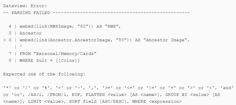

I searched for every term I could think of that would be relevant, but I’m not sure how to describe the problem, so didn’t find anything. I guessed the syntax should be something that describes the link like this:
… but obviously that doesn’t work.
