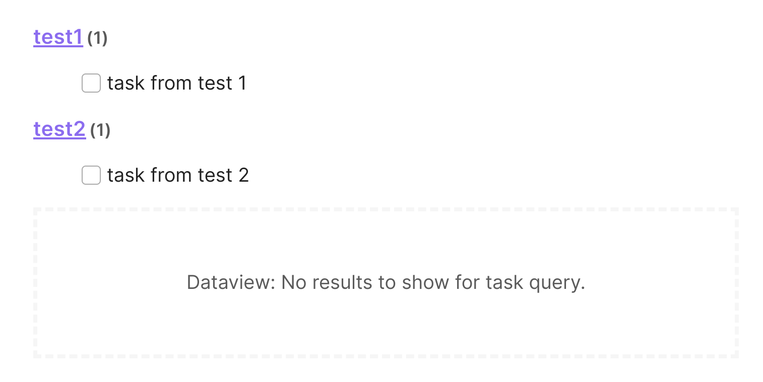

Update (Code works but a bit off):
I checked the task in “test3” as completed and now it shows this huge “Dataview: No results to show for task query” in place of “test3” block. It takes up a lot of space in the note. How can I remove this?
Here’s the output after checking task in"test3":
