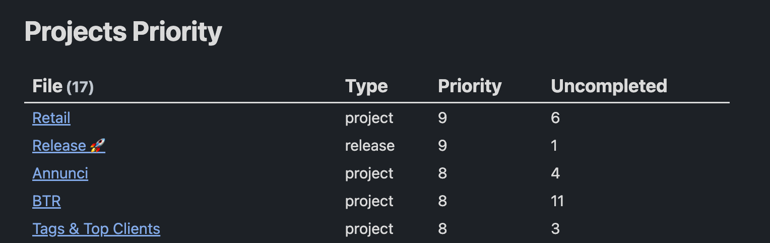

Hi everyone, first days for me using this fantastic tool!
I found this great query that helps me sort my Projects by priority (which is a page property) and count all the uncompleted tasks inside of them.
table type as Type, priority as Priority, length(filter(file.tasks, (t) => !t.completed)) AS "Uncompleted"
from "Projects"
WHERE file.tasks AND length(file.tasks) > 0 AND length(filter(file.tasks, (t) => !t.completed)) > 0
sort priority desc
I would like to add a new column called “High” that counts only the high priority tasks (the ones containing :small_red_triangle: or :arrow_double_up: in the text).
Can you help me do this? Thansk

Thanks for the answer holroy.
Unfortunately not, currently i’m trying this but it doesn’t work
table type as Type, priority as Priority, length(filter(file.tasks, (t) =>t.text.includes("🔺"))) AS "High Priority"
from "Projects"
sort priority desc
