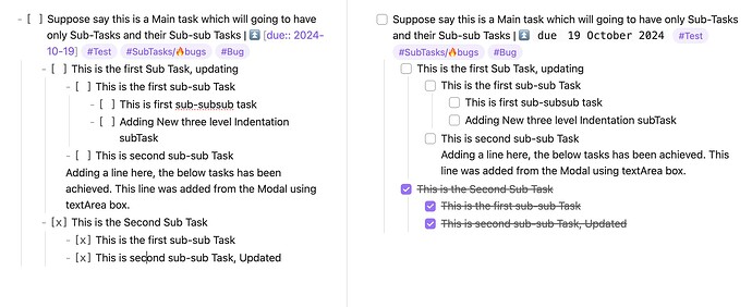

Source on the left; reading on the right. Is this what you expect? (Raw text below. Hope it copies from the forum.)

So the line “Adding a line here, the below tasks has been …” should always be indented to the same level as its previous line ?
