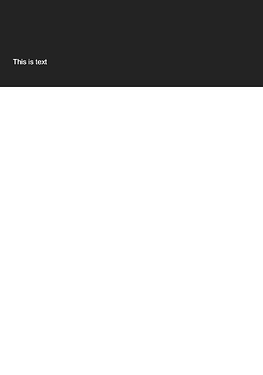

Besides the white margin at the bottom of the page, the biggest problem I’m running into is that my customized callouts are disappearing in the exported PDF. Specifically, the callouts and their contents aren’t visually visible, but text in the callouts are still there?
I have several customized callouts for floating callouts, etc. but for a simple example, I’ll use a note with this custom CSS to change the color of the info callout.
.callout[data-callout=info] {
    --callout-color: 140, 195, 230;

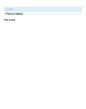

Normal PDF export:

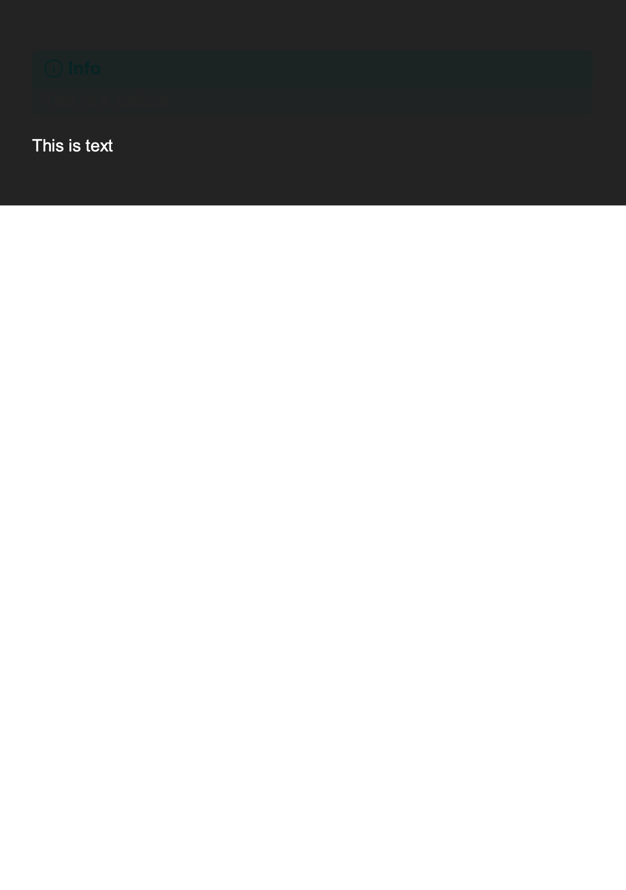

Export with the above CSS snippet:
All text on PDF highlighted, to show that the text in the callout is there:
To note, any images inside callouts also become invisible.
When I remove the custom CSS for the info callout, this is what the export looks like:
It’s still not readable.
I tried adding the custom CSS for the callout under the @media print code, but nothing changed.

The issue isn’t the custom info callout there, that’s fine, it’s that you are setting a background-color: rgb(30, 30, 30); on the markdown-preview-view container/section without adjusting anything else. A lot more needs to be changed.
Give this a shot; it seems to still be working in a quick test using the default theme:
Yes, that snippet works perfectly! Thank you for sharing! :smile:
