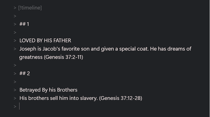

I am trying to figure out why mine looks so different. Here is the source mode

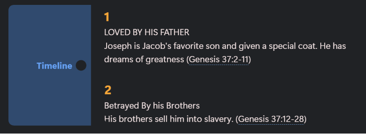

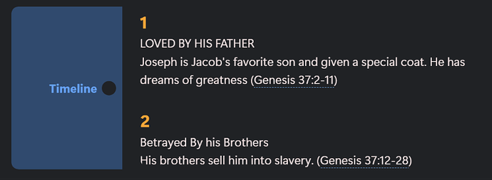

And here is the Preview mode.
I am using the Baseline theme.
Thanks!
