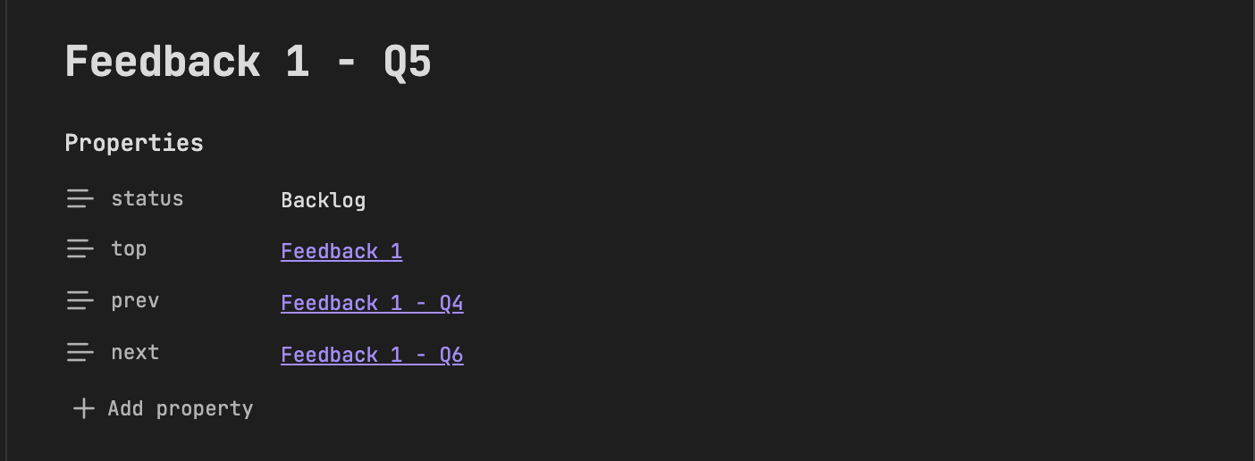

There’s an option in the field’s settings to Enable rich text formatting … which I had to toggle On to have the links from Properties displayed as clickable links in Project
… I don’t know if this will help you though :innocent: .
