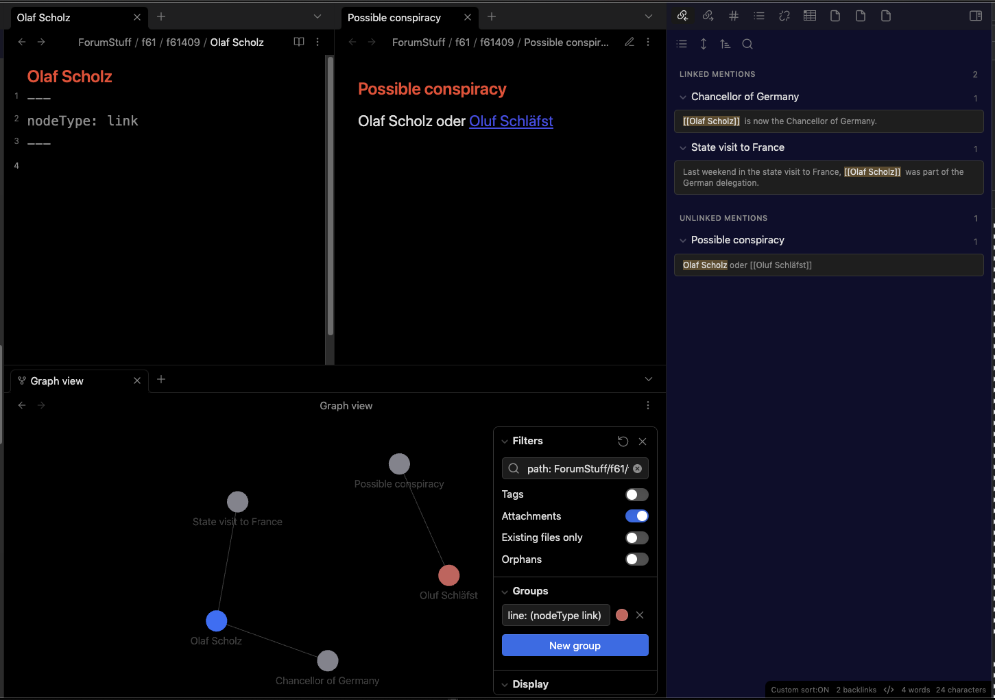

Here is your example using these concepts, and few additional notes:
In the bottom half of this image, you can see the link you wanted to see. It’s currently shown with a blue node, since this is also the current node in the upper left window.
The content of the “Olaf Scholz” note could be almost nothing, and in my example this note and the “Oluf Schläfst” note they both contain just the frontmatter:
nodeType: link
And if you look in the Groups section of the Graph view I’ve used the search line: (nodeType link) which would select both of these notes, and I’ve given them the color of red. This way all my ordinary notes are grey as a default color, and the linked notes are red (except for the current note which is blue).
In the side panel to the right you can also see the linked mentions related to the “Olaf Scholz” note (and this panel will follow your currently selected file), and here you can see that both the known links are shown at the top (under the “Linked mentions” heading), but also that the not linked mentions where the name is just text is listed under the “Unlinked mentions”. This can be very useful to see unknown connections, and help you discover links which should have been there.
