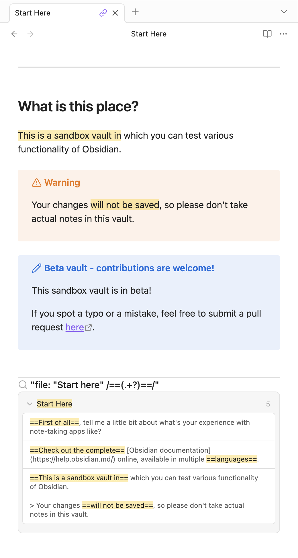

Now, what I need is to have a single place where all the highlights that I made inside the note are visible at a single place, inside a single note, with their links to the original notes. so that I can review all the highlights in a very convenient manner.
A single place, a single note which keeps track of all the highlights in an easy to traverse or navigate manner, and even easy to read.
You could try an embedded search/query for this. e.g.
```query
file: "Start here" /==(.+?)==/
  • file: "Start here" restricts the search to that note only.
  • /==(.+?)==/ searches for any text between double == marks.
