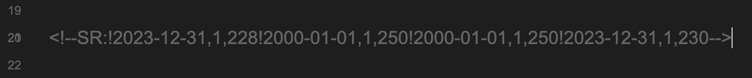

I should also add that I use the Spaced Repetition plug in, and the HTML style comments it generates also have the same behavior… although the combined line numbers remain even after arrowing onto the commented line…
