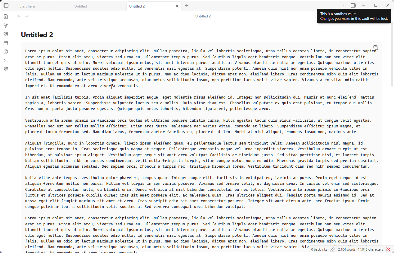

Codeblock copy button not appearing every time for codeblocks containing large amounts of text
Create a new vault.
Create a new note in that vault.
Open codeblock.

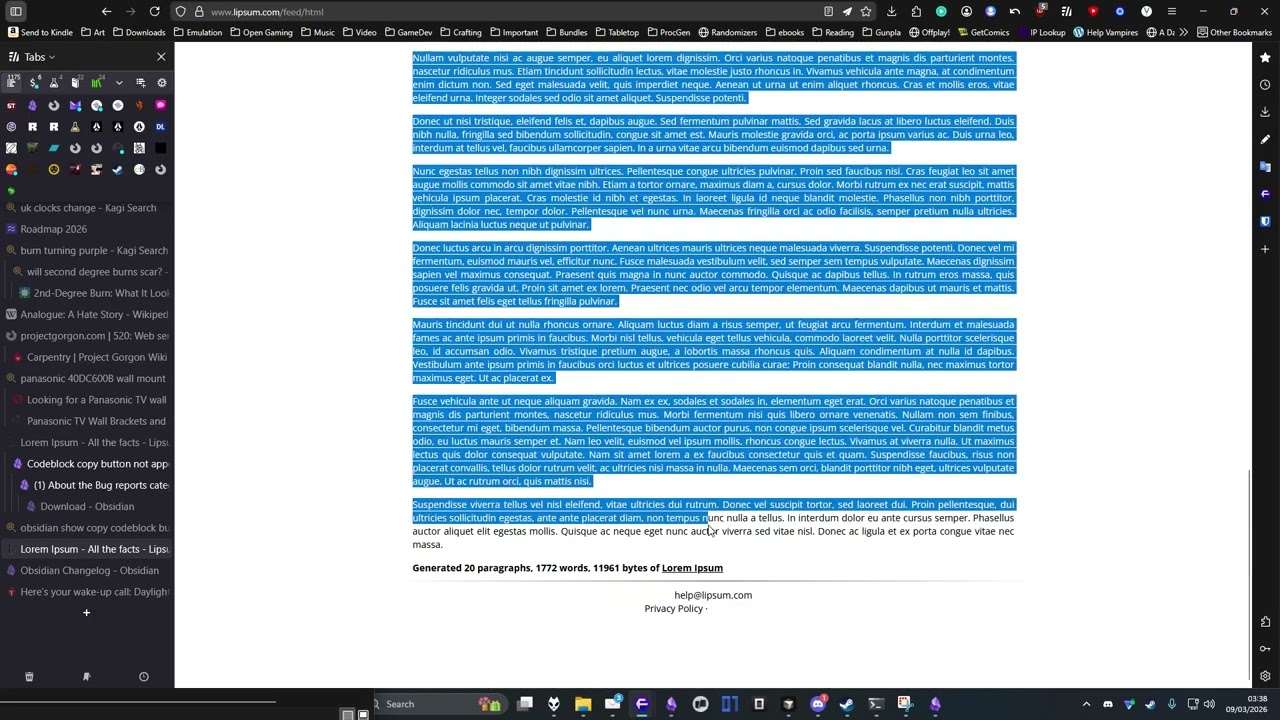

Generate twenty paragraphs of Lorum Ipsum from here: Lorem Ipsum - All the facts - Lipsum generator
Copy the lorem ipsum passages into codeblock.
Click outside of codeblock (to title of note? Somewhere.)
I expect the copy codeblock button to appear on the lorem ipsum codeblock, as I no longer have the cursor within the codeblock.
Copy codeblock button will (probably) not appear.
Obsidian version: 1.12.4
Installer version: 1.5.8
Operating system: Windows 10 Home 10.0.26200
Language: en-GB
Catalyst license: insider
Clicking below the codeblock and adding a new line or deleting a line below it will sometimes cause the copy button to appear, but after typing in the codeblock and clicking away again it can just fail to show up again.
If you create a newline/blank line at the top of the note, you should be alright and have a place to click into outside of the code block.

obsidian-bug-codeblock-copy-button-ezgif.com-video-to-avif-converter
Hm. I edited the note from my clip above (adding a few random characters here and there) and the copy button appeared as normal when I clicked out of the code block.
I’d update your installer to see if you see any change and report back.
Done, no change. In the sandbox vault, following the steps above, the button failed to show up after editing the contents of the codeblock, no matter where I clicked. Even after typing outside of the codeblock, mousing over the codeblock sdoesn’t cause the copy button to appear.
Adding two linebreaks below the codeblock does make it show up… until I edit anything in the codeblock again, at which point it just stops appearing (this is behaviour it was demonstrating previously; not really a usable workaround).

The avif in my post two above is demonstrating it happening in the sandbox vault, but here is a complete recording of my entire screen replicating the issue in the sandbox vault:
Sorry, it was late when I recorded the video for that last response, and I completely forgot the other half of the response.
Here’s a copy of the Lorem Ipsum page from the sandbox vault attached; it’s recreated (for something like the fourth or fifth time at this point), but I’ve confirmed the issue occurs with it.
Open the note, edit the codeblock (even just adding or removing a single space), click outside of the codeblock: no copy button appears.
Lorem Ipsum.md (12.2 KB)

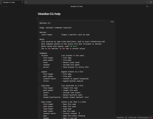

FWIW :blush: I’ve been running into what dawni describes here:
… while storing the output of the obsidian help --copy command (from the CLI) in a sh code block in a note in Obisidian :blush: …
Pasting the output of the command in the code block seems to work as expected (the code block is rendered and all) but the issue arise after closing and re-opening the note…
I have to scroll down a lot (~3/4 of the length of the whole code block) for the code block to render as such :woman_shrugging: …
Switching from Live Preview to Reading to Live Preview doesn’t help either.
Code block scroll
