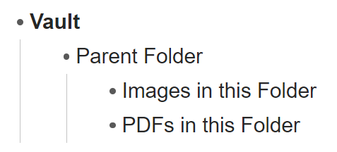

My usual folder structure is like this

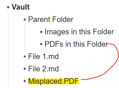

And I try to always put my Pdf documents into the PDF folder, but sometimes I forget and they appear as below:
and the Pdf file isn’t in the correct folder.
