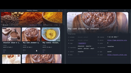

So, I thought of an alternative so as not to have to enter the note or navigate through the preview to modify a checkbox property.
Among my bases, I have one that groups my cooking recipe notes, and a menu property that indicates if it is planned for the week. I wanted to be able to quickly add a recipe to my weekly menu by clicking on the property in the card.
Since I regularly use Quickadd, I used these features. (I first tested with Advanced-uri but you cannot modify a boolean frontmatter property).
So, I created a Quickadd macro that takes a filename value entered as a parameter and toggles the desired property in the frontmatter between true and false.
I then used the new feature allowing a URI link to be rendered in a formula in a base with link, to create a URI towards my Quickadd macro, with the note name as a parameter, displaying it as an icon depending on whether the menu is true or false.
To create it, you first need to create a Quickadd macro with a script like this, here I hardcoded the path to my recipe notes, but it is also possible to include it in the URI parameter along with the note name:

Next, you create a formula in your base like this one. Here I named my macro inmenu, and I display a check icon if the recipe is in the menu, otherwise circle:
link("obsidian://quickadd?choice=inmenu&value-file=" + file.name.replace(" ", "%20"), if(menu, icon("check"), icon("circle")))
So, this gives something like this:
exemple_bases_checkboxes
I am sure it is also possible to adapt this method for properties other than checkboxes, using quickadd inputs.
