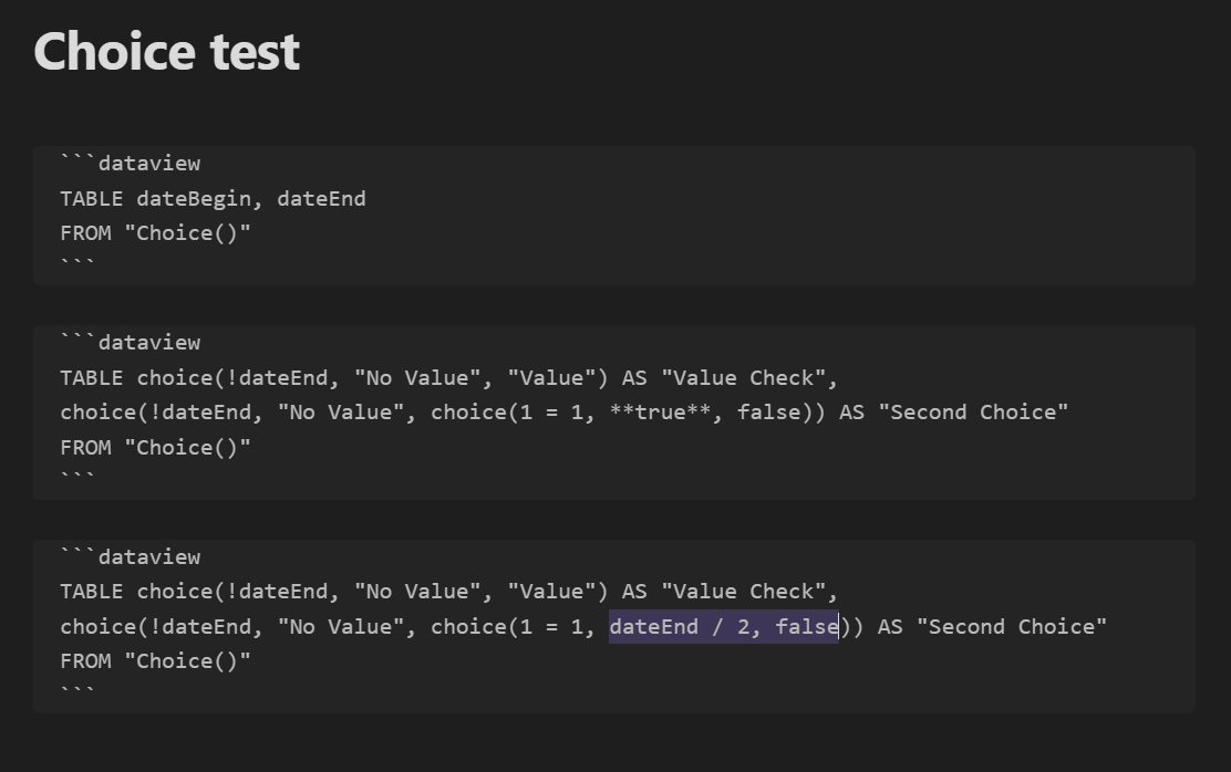

Im trying to execute a choice function nested inside of a other choice function. The first choice functions evaluates whether the target is empty and returns “No value” if thats true and execute the the second choice() if false. The second choice() will check for the value of the target and will decide what to do next based on that value.
The problem im running into is that dataview will evaluate both conditions and returns “no implementation found for ‘null / number’” if the target value is null, instead of returning “No value”.
In the first image the properties and error message is visible, in the second image the queries.
The second query is the exact same as the third query, except for the true statement in the second choice function. In my eyes it shouldn’t evaluate the second choice() true statement and therefore should not give me the error. Is this a bug or am I not understanding the function correctly.

I reckon this behavior is due to how dataview parses the query, and that this can’t be easily countered. I tried with an even simpler statement of choice(false, dateEnd / 2, "hmmm"), and it failed. So I do believe this is something you need to handle a different way.
One such way could either be to require that dateEnd always has a value, as in doing something like WHERE dateEnd in your query, but I reckon that doesn’t match up with the rest of your query. Another option is to give the wrongful entry a “legal” value, even if it doesn’t exist. This can be done using something like default() in constructs like: choice(false, default(dateEnd, 1) / 2, "Hooray"), which would reliably produce “Hooray”.
A more constructive variant would of course be to do: choice(!dateEnd, "No value", default(dateEnd, 1) / 2). In this case if the dateEnd actually had a value, it would be used instead of the 1, and your query would behave. If no dateEnd it would use the 1 value, which would produce some random value, but it’ll not be used due to the choice function.
