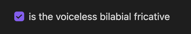

Checkboxes get filled with any character
Checkboxes get filled and rendered any time there is the sequence - [<char>], that is a character in square brackets after a bullet point.
This makes it annoying when writing notes on phonology in linguistics, because you may want to start a dotpoint with an IPA transcription, but it gets consumed and rendered as a check box.
For example
  • [ɸ] is the voiceless bilabial fricative
becomes
Only consider checked checkboxes as [x] which is the current default. (The voiceless velar fricative must be sacrificed for the greater good).
Or perhaps add a setting that can specify the default character to fill a checkbox, and then any other characters that should be recognised as filled checkboxes. For instance, default: [+], recognise [-], [x].

A lot of people use this alternate checkboxes, because you can style them as different symbols. I think they will not agree with them being removed.
In your case you can use either backticks or backslashes to avoid rendering checkboxes. I.e. you can use one of those:
- \[ф\]
- `[ф]`
yeah, I think you should use inline code for your use case.
