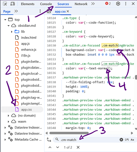

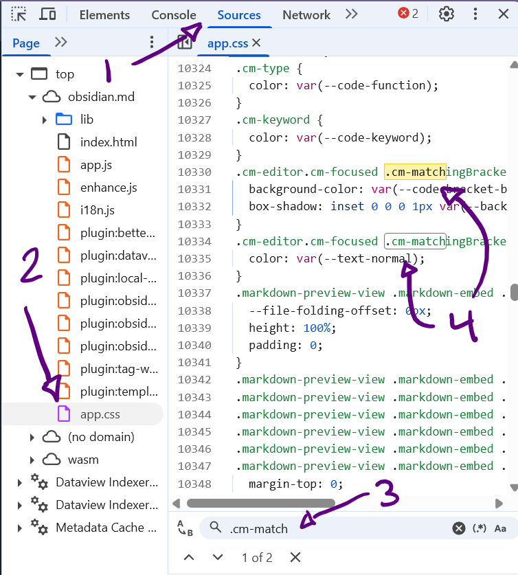

In dev tools:
  1. click Sources
  2. browse to app.css
  3. press Ctrl + F / Cmd + F to pull up the search bar, and type in the selector
  4. see what the style sheet has to say for itself
You can download the entire document from there if you want, but I search it in-place.
