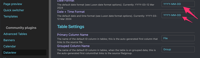

This is what I currently have in the settings of dataview for date format. I even changed the date + time format to only have the year, month and date in desperation - to no avail.

That means some of your files don’t have the date in the file name, so the file.day isn’t defined.
Either you need to detect which files that is, and do something with those files, or alternatively you could add a .where(p => p.file.day in front of the mapping (and thusly remove the files causing the error).
That was it, indeed! Thanks a lot.
