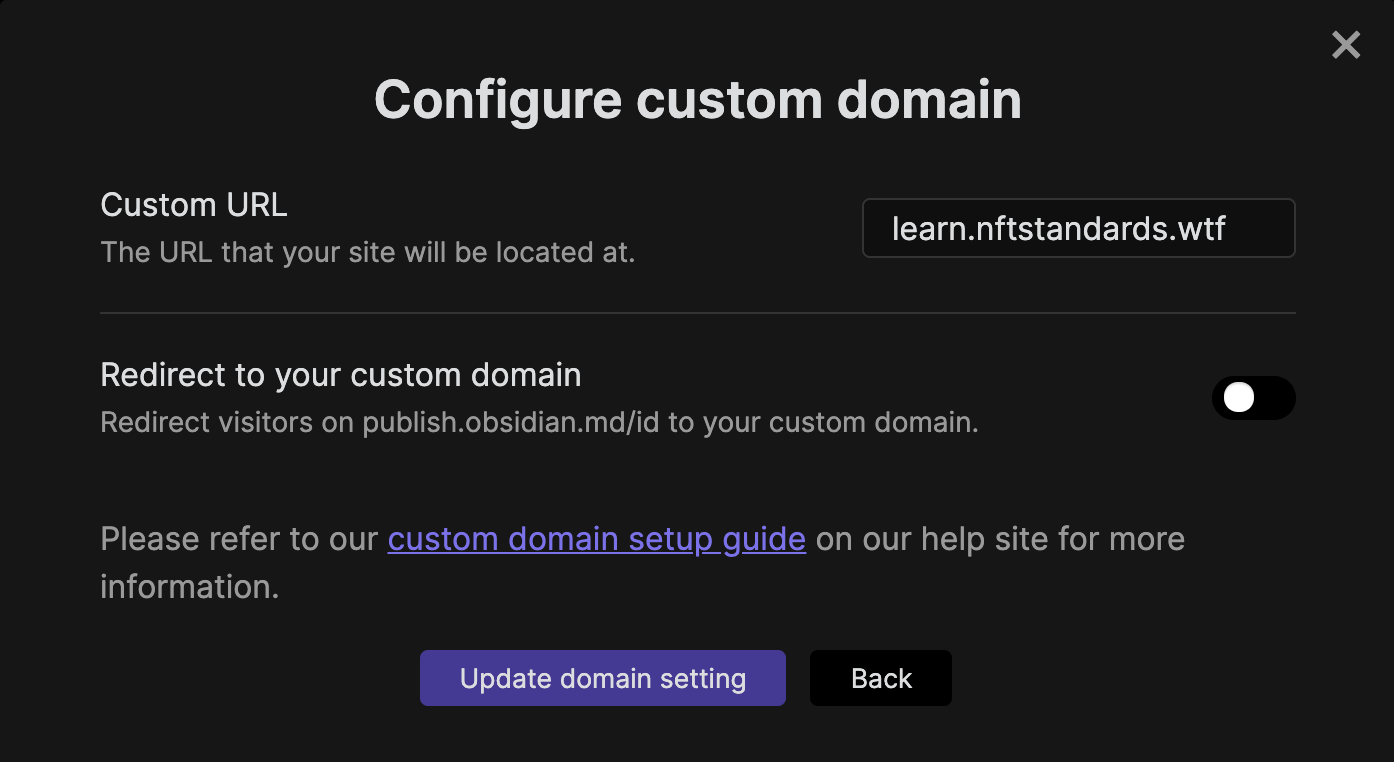

I’m using Obsidian Publish and bought domain via namecheap. I do have problem with DNS certificates on my custom domain
I configured DNS based on the instructions for setting up custom domain in Help Obsidian. I’m not going to copy paste it since I did everything step by step as it is in noted in doc.
Website would work and show documents on learn.nftstandards.wtf . It worked when I used publish.obsidian.md domain. As soon as I switched to custom domain I started to have troubles with certificate.

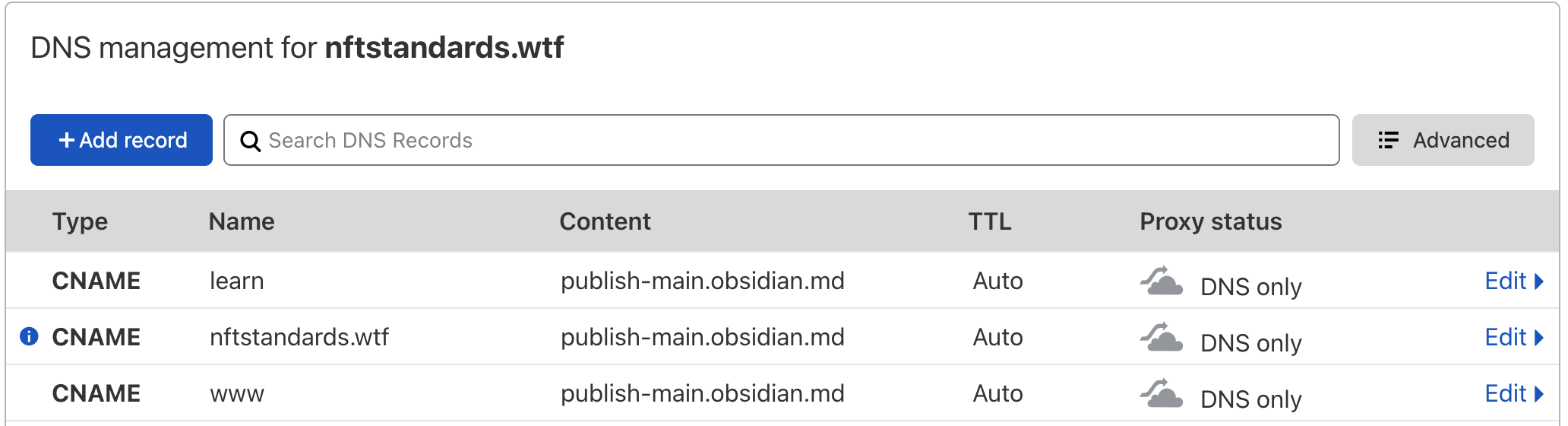

Current DNS setup:
Configuration setup:
Is there a reason you have it set to ‘DNS only’?
What are your encryption settings?
Why are you redirecting all subdomains to obsidian if you only want learn?

Then in Obsidian help guide / tutorial should state that it should be proxied only as with DNS only it doesn’t works.
The reason why I set it as DNS only is as I make changes to the docs often and I would like to reflect changes ASAP on the website. Which with proxied it takes time to reflect changes that are made in the doc.
In the Help documentation it should be stated in the page rules to add domain name without “www” and also that it works only when the proxy status is “Proxied”.
