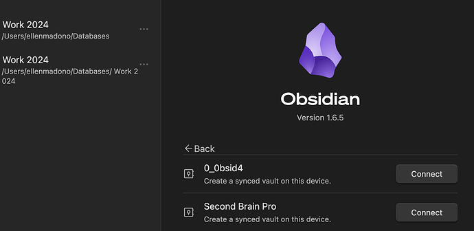

In your screenshot it says you’ve reached the maximum number of remote vaults for your Sync plan.
You are right. How can I get Obsidian to recognize my new vault?
I can see the hidden files. (Command shift Period) My new vault is not in my documents file because I thought there was some problem with being in iCloud. It needs to be in my documents folder which will automatically sync with iCloud. I want to use Obsidian sync. In the screenshot below, the old vaults are the only vaults set of syncing. I tried to make a new vault, but that did not help at all. I trashed it, but it still appears in the screenshot below.
How do I get rid of them? How do I get my new vault synced?
Did you switch Sync plans? I’m guessing you are on the “Sync Standard” plan? Only one remote vault is allowed; I’m not sure how you ended up with two there.
You remove any remote vault(s) with the trash can icon in your first screenshot. That screen is under Settings > Core plugins > Sync → Manage.
Thank you. Problem solved.
