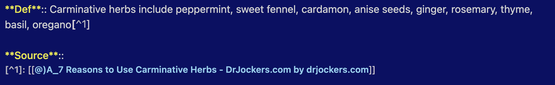

Sometimes (but not often), footnotes render correctly in Preview mode, but most of the time footnotes do not render or link properly. Screenshots below of both edit/previews for when it worked and when it didn’t.
In addition, sometimes it works on a page initially, then when I edit anything on that page (not just the footnote), it breaks the footnote.
Example of it working:
EDIT:
PREVIEW:
Example of it not working:
EDIT:
PREVIEW:

I can’t seem to replicate it consistently. I’ve tried removing all formatting, links, and attributes, and fiddled around with various spacings before and after links and elsewhere – but still, sometimes it works and sometimes not (again most of the time not). The only thing consistent is that once it doesn’t work on a page - it never works on that page (even if it had worked at one time).
Any hints, if I’m doing something wrong, would be appreciated, or maybe it’s a bug? Thanks!
I think you need to add a blank line after Source::
Try that.
Wow. That simple. It worked! Thanks so much. Appreciate the response.
