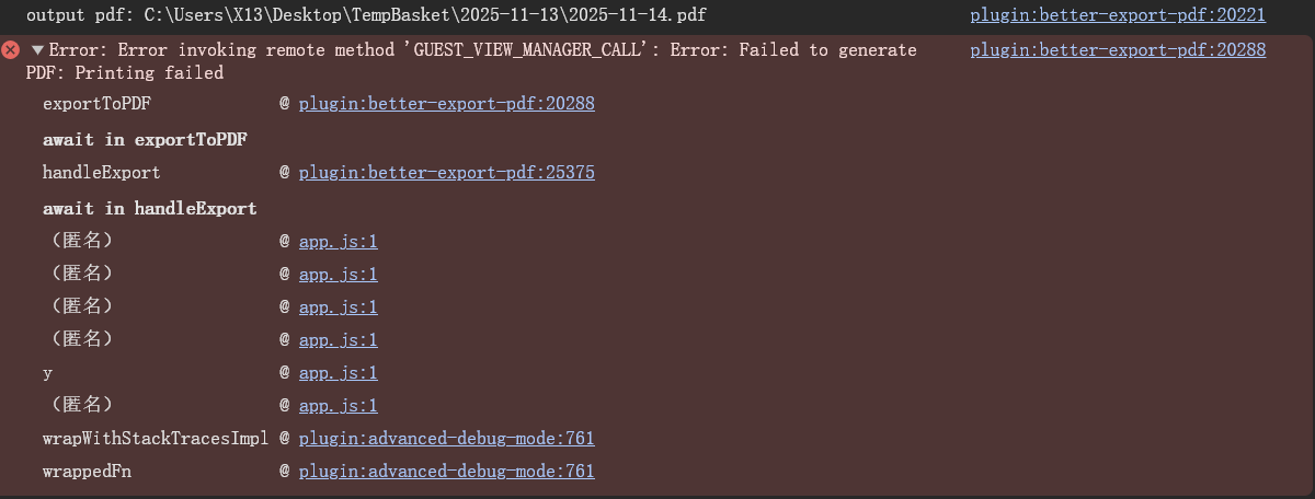

i also tried better export to pdf plugin, no pdf is generated. but this time, a error message is given in the console:
is there anything that i can do to look into the obsidian work flow that export the pdf, so that can help find the cause?
