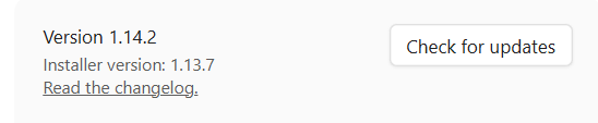

Can you check to see if a new Installer exists from within Obsidian?
When I check for new updates for obsidian, I assumed that it was also keeping the installer up to date.
It doesn’t appear to be the case.
Is there an easy way to know if I am behind in installer updates ?
Obsidian doesn’t seem to tell me “You are up to date”.
I just get this spinning graphic.
and then the
comes back.
Is this normal >?

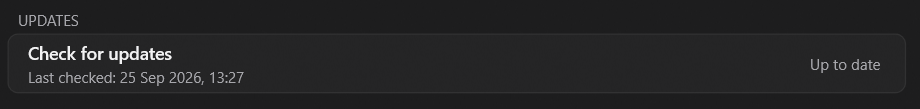

When there are no new updates. There should be a message saying that much.
It feels like the query fails. And there could be updates, but the [Check for Updates] button isn’t working.
Something like this would be useful.
That would be the installer right ?
and this one
checks for b.
It will be possible in 1.14.3+
Correct.
