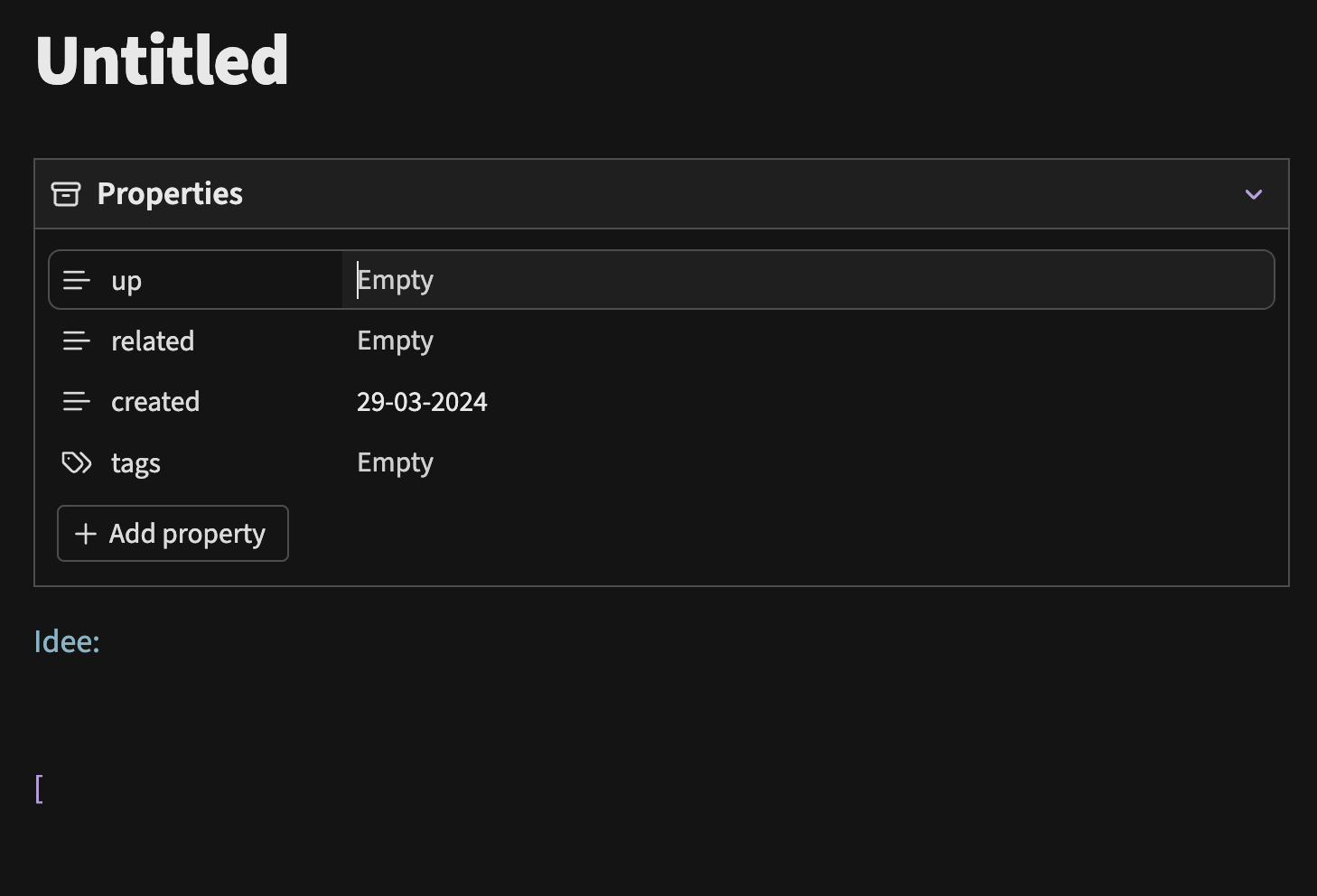

I tried to copy the properties template of Nick Milo´s ideaverse and it looks fine and works except for that I cannot insert links to notes/double brackets inside the properties. when I try the brackets appear in the note. I provided a picture of what it looks like in reading mode. Does anyone know what the problem could be?
thanks in advance!
What’s the source look like? It should be something like this starting at line one of your note:
up:
- "[[Home]]"
related:
created: 2023-08-30
tags:
- map
thank you!
the quotation marks around the double brackets where the missing link!
