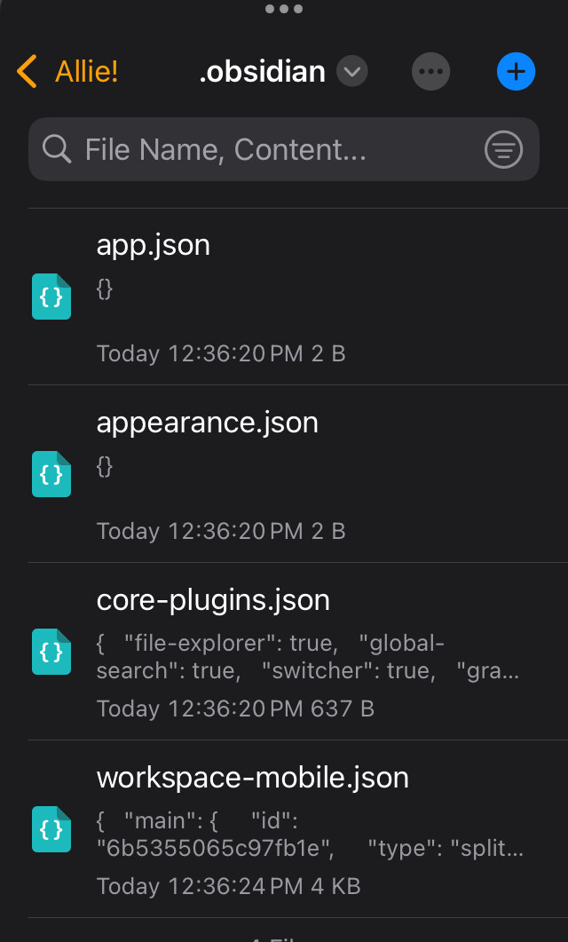

I was trying to find the snippets folder on my iPad i downloaded Taio so I can see hidden files and I went into the .obsidan folder but I don’t see snippets and I only see these folders
I tried reinstalling the app, I tried making a new vault but I still don’t see the snippet folder in any vaults I create.
You need to create the snippets folder. Obsidian will not create it.
